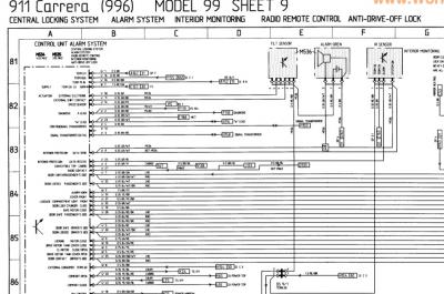

  3. Update... I finally had a new sensor (number 2) from the dealer, now I have fault 33 & 34! I do not have the Alarm Siren and the tilt sensor, I checked the compartment monitoring sensor by closing the car with the remote and keeping the window open, after 30s if I move my hand inside the car the alarm horn goes on! so the sensor is actually working?!
  4. Update, I do not have the Alarm Siren and the tilt sensor, I checked the compartment monitoring sensor by closing the car with the remote and keeping the window open, after 30s if I move my hand inside the car the alarm horn goes on! so the sensor is actually working???
  5. Yes, I've checked pin 1 and 4 on the sensor plug, I can read the battery voltage... Anyway I finally had a new sensor (number 2) from the dealer, now I have fault 33 & 34!
  6. Ok... I checked both, so actually I don't receive signals from the wiring, the wiring harness is ok! is it possible that the new passenger compartment monitoring sensor is broken? will try to get another one tomorrow at the dealer...
  7. but.... should I check the pin 24 and 8 on the control unit alarm system or should I check pin 24 and 8 on the plug A by itself?
  8. I'm having voltage ON at pin 24 but I already unplugged the siren and the interior sensor before testing, at this point should I try to connect 24 to 3 with a straight line?

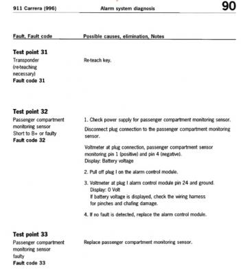

  11. I've the 96-39 Fault code 33... Replaced passenger compartment monitoring sensor, but nothing happened.. I'm following the instruction for the fault code 32 (it look to be the same as 34) I have a battery voltage displayed instead of 0, now, how I can check and repair the wiring harness??
  12. I'm not randomly changing parts, the workshop manual literally says "Replace passenger compartment monitoring sensor" for the error code 33.
  13. I'm trying to fix this problem since 3 years or more... finally got my PIWIS, the fault code memory says "33", at page 90 - D 41 of the workshop manual it says "Replace passenger compartment monitoring sensor", I replaced it for about 130€, nothing changed... same fault code! So, I started to do all the tests points of the workshop, from number 22 to 36, and the only thing I discovered was an issue on test point 32 step 3, now the solution is to "check the wiring harness for pinches and chafing damage"... My question: is there any simple way to test this wiring harness??
