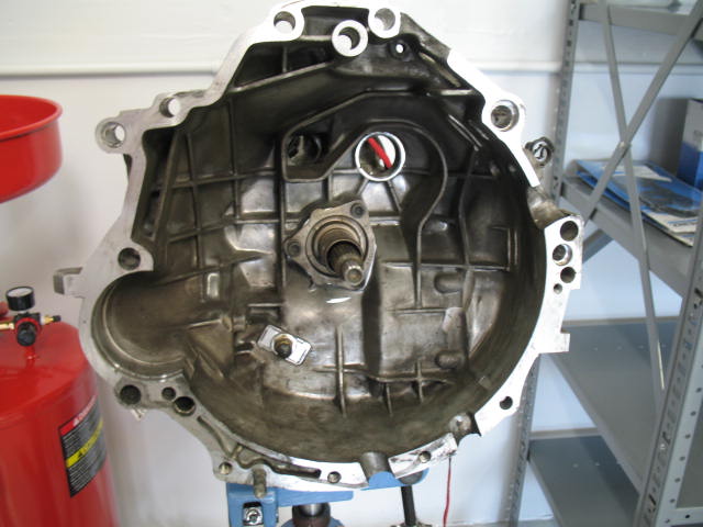

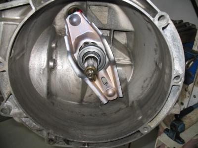

  12. Do you know Marvin Weitz? I did not replace the clutch, Marvin did. Here is the bell housing of my Boxster transmission after it was removed. He cleaned it.... He put in a clutch kit. The kit includes the disc, pressure plate, and release bearing. Sorry, but I forgot to mention the replacement of the bearing.

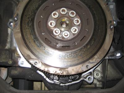

  15. I do not know any local dealerships that have this done. They have to get your car in and out and off the rack, and it is faster to put in a new one. Plus they like putting in new parts as it is less likely they will see your car again for the same thing. I had my Boxster clutch with 67,000 miles replaced last week at an independent shop run by a mechanic who use to work at dealerships. I checked the flywheel and it looked fine other than the typical heat checking. The disc was not down to the rivets on the flywheel side so the flywheel was not scored. He asked if I wanted it resurfaced, or to put in a new one. or to reuse it as is. He did not tell me there could be problems if I had it resurfaced. I had medium clutch chatter, so if I did not replace or resurface the flywheel and if the chatter was still there after the clutch replacement - "then he told me so." I had it reused as is and just the disc and pressure plate were replaced. Clutch works fine. Mechanic was also replacing the clutch on a C4S. The flywheel looked like mine, but the owner elected to have a new flywheel. That is the second picture, of a new flywheel.

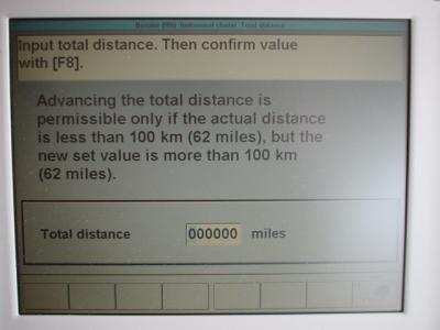

  16. With a PST2 you go to special function, sports car hand-over. This is supposed to be done by the dealer before delivery to the customer, but sometimes they forget. About once a year on the message boards someone who just bought a used older Boxster wonders why the interior and trunk lights will not come on unless the ignition is switched on. Turns out the hand-over was not done and the car has been in the transit mode all these years.
