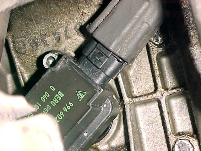

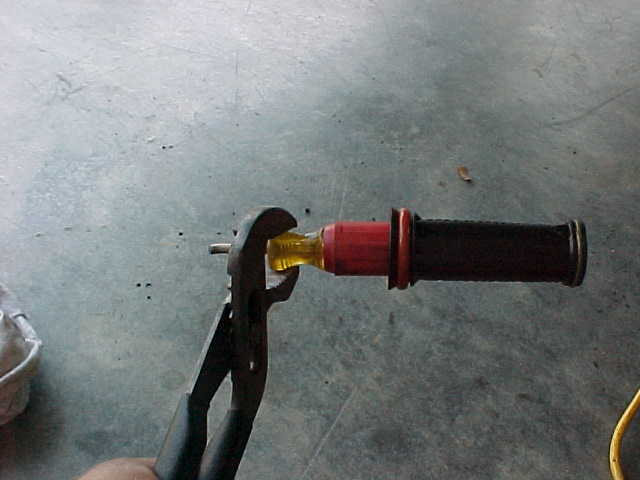

  4. Gang, got the plugs and tubes changed today. Some ideas on removing the tubes with this expensive and complicated tool: It is an old screwdriver with a rubber handle. The tubes are tapered, so the handle fits most of the way in, then pull out with a pair of pliers and presto, tube is out. Took some practice to get the technique, but once I did the first ones, the rest where easy. Pull it out in an slight angle to give it more friction. Another trick in changing the spark plugs, pull out the rubber boot from the coil connector, makes it a lot easier to remove and reattach later. Last trick was related to removing the coil bolts on the rearmost side. Big pain to get to them. Allen 5mm standard wrench can get it loose, then you have a hard time getting your fingers to undo the bolt. Here is what worked for me. A T-30 torx bit. It fits inside the bolt (almost same size as the 5 mm Allen) and then your fingers have a heftier mass to unscrew the bolt. It took me an hour to figure this out while I stare at the little *$**)$(@** bolt. Now the point to ponder, as I was finishing the work, hands and elbows black, it is 98 degrees outside, dirty. My wife walks by and says "in this fun?". I said "Hell yeah!" Have fun and be safe. I built and tested the tool for the Tiptronic fluid change. Will do a detailed step by step after I do the work and change the filter/fluid in the tranny. Izzy
