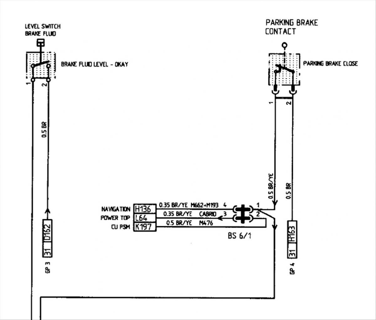

  1. In regards to the parking brake dash light.... IF the light is ON on the dash (when the parking brake is pulled up/engaged), "most likely" the switch is "OK".....but it may still be a problem when you activate the convertible top. IF the light is OFF on the dash (when the parking brake is pulled up/engaged), most likely that is the problem. The diagram attached is for a 1999 996 convertible.

  9. Numerous reasons....but I will give you 2 clues and do a search in this forum......this has benn discussed enough times... 1.- When parking brake is up....is the light on the dashboard on? 2.- Does the clamshell move up/down?

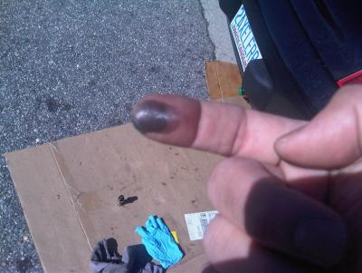

  16. I have had the magnetic plug for a while...I never get any metal particles on the filter...the magnetic plug is a different story...there is always a metallic "dust" on it....
