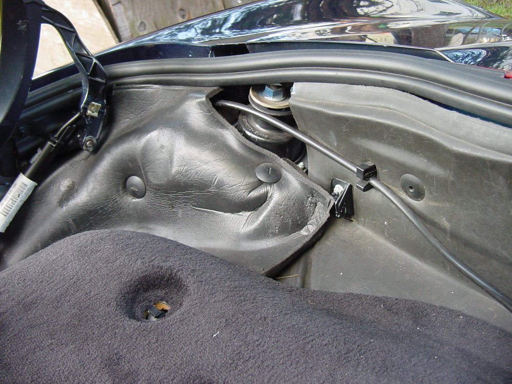

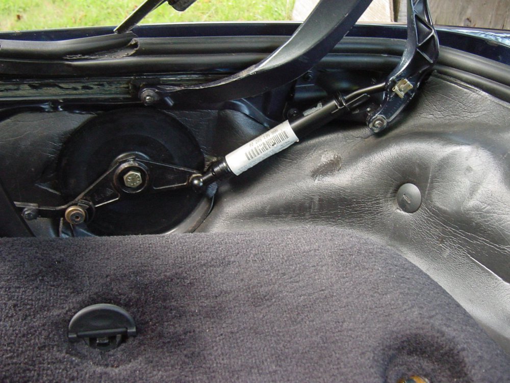

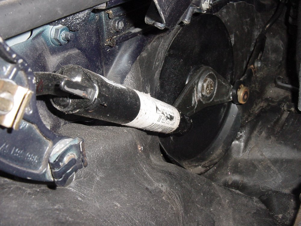

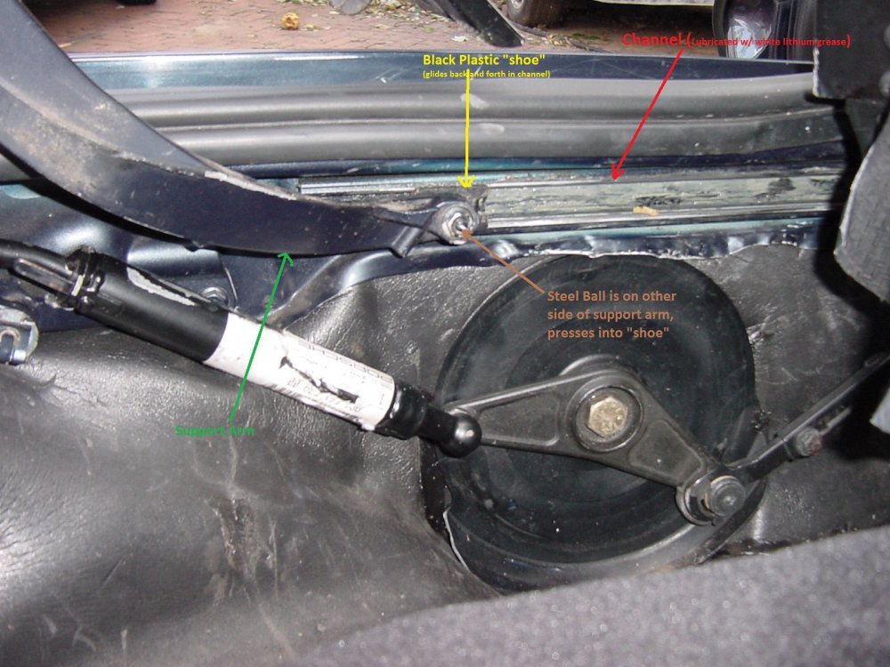

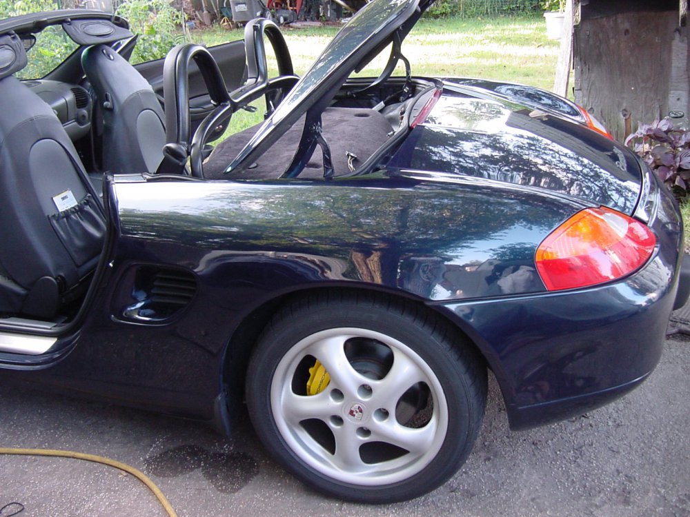

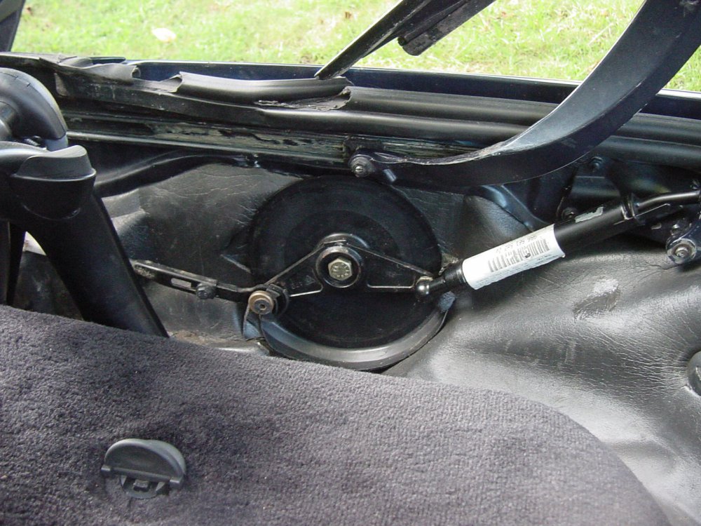

Sorry for the delay, but the Virus has made things upside down everywhere around New York. Hope it's not too bad in Cleveland.:) I think I found some initial pics that can help you get started in solving the problem with your top... Here is a series of photos on my '97 Boxster when it still had the original "A Version", all metal housing transmissions. I think that if you put your clamshell manually to this exact position, and then duplicate the position of the V-levers and other parts, you will have an excellent starting point. Forgot to mention what the red arrow and the yellow arrow are pointing to in the last photo posted(367.38 kB)..Red is pointing to the "fat washer" under the 10mm bolt which in turn holds down the small flat bushing/sleeve (Yellow arrow pointing to joint) that keeps the overall length of the pushrod in its set position. Of course that has a major effect on the position/attitude that the leading edge of the convertible top will have when it is in its pre-latching (or immediately post-latching) position. A relatively tiny difference in overall length will also have a relatively drastic effect on whether that "final" position ends up correctly aligned or whether the leading edge of the top goes past its forwardmost position and then starts to retract...then making it impossible to latch the top securely. To achieve a finer adjustment, don't loosen the 10mm with fat washer, use each 360 degree turn or rotation of the plastic ball cup on the forward end of the pushrod to change the overall length of the pushrod. Let me know if that works, otherwise I can look for some more. Regards, Maurice. -

From your update, it sounds like you have to identify the rails, channels or other surfaces on which rollers or plastic pads slide and clean and lubricate those surfaces. I'm not intimately familiar with Targa roof mechanisms, but some general rules apply. As an example, the 986 Boxster (as well as other Boxsters) have a clamshell that is supported from underneath by two arms (left and right). Those support arms are attached to the underside of the clamshell and the other end of the support arms terminate in a steel ball that is installed at a 90 degree angle to the arms. Each steel ball (one left and one right) is pressed into a plastic rectangular "shoe" which is inserted into, and which literally slides back and forth in, a horizontal metal channel as the clamshell goes to the up or the stowed position. If that channel or the plastic "shoe" is not lubricated or gets contaminated with dirt, it will manifest itself reliably with a judder and a slowing down of the thus struggling mechanism. As soon as you clean that channel and the plastic shoe and lubricate those parts, the difference is shocking. I cannot overemphasize the effects of dirty and/or non lubricated parts on these mechanisms and, if you are able to locate the equivalent channels on your Targa and clean and lubricate them, I am reasonably confident that you will be pleasantly surprised at the effects. At the very least if lubrication does not ameliorate the situation at all you will have narrowed it down to a mechanical or component part failure. Here is a photo of the type of channel and parts I was describing, this one from a 986 Boxster. Regards, Maurice.
You can at least buy some time, and maybe even get a pleasant surprise by following the recommendations above regarding using Krytox and/or White Lithium Grease. The judder you refer to is almost always caused by lack or absence of lubrication or dirt contamination of the old existing lubricant. The "slow" aspect you describe may possibly be caused by the increased resistance the mechanism and the gears are struggling against due to lack of proper lubrication. The photos generously provided by "Fixxxer" can guide you to get started, along with the instructions provided by "jay04v6". If it works, you can educate the dealer. :) Regards, Maurice.
