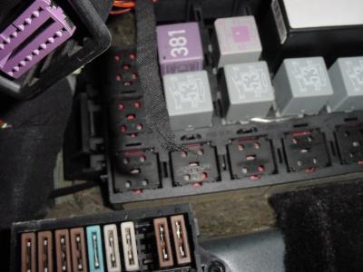

  9. It's the OBD II port under the dashboard, above and to the left of your left knee as you sit in the driver's seat. Here's a photo showing the location. In this photo, it's the purple part near the top left corner of the photo. You can see the fuse panel on the kick panel below it. There is only one way to connect it, but make sure it is fully seated. Regards, Maurice.
  10. Helen: The fuse tray is labeled with numbers 1 to 10, running from left to right, but the numbers are tiny. (Click on the photo and you can see the numbers). Row A is the topmost row, and Row B is below it, down to row E at the bottom, with a row of spare fuses beneath row E. Here is a photo of the fuse tray location, Fuse A1 is at the top left, etc... Note that this photo of the fuse tray is of a U.S. car, so I don't think that you will have the "dead pedal" there on your car. Also, here is a photo of the the location of the double relay, located above the fuse panel and towards the front. Regards, Maurice.

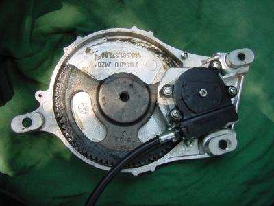

  18. Definitely sounds like there is a problem with the left side transmission. You can remove the 19mm bolt that holds the V-lever onto the transmission and remove the three nuts that hold the transmission onto the studs that are mounted on the inner quarter panel. Then you can open up the transmission to determine what is causing the excessive play. Make sure that you note and mark the position of the female keyway and its relation with the V-lever because it can be mounted two ways: the correct way and 180 degrees off. Here is what it looks like when you have taken it apart: Did you "tweak" the clamshell? If you did, and it's not severe, you can pull off the clamshell and, with the help of a friend, you can bend it back into place. There is a thread here somewhere by "Tool Pants" that shows you how to do that. The body-colored brackets don't bend easily. They are either okay or they crack. Regards, Maurice.
