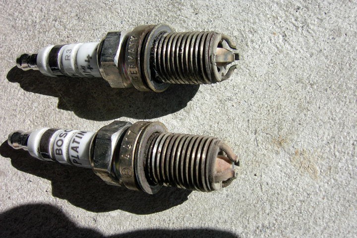

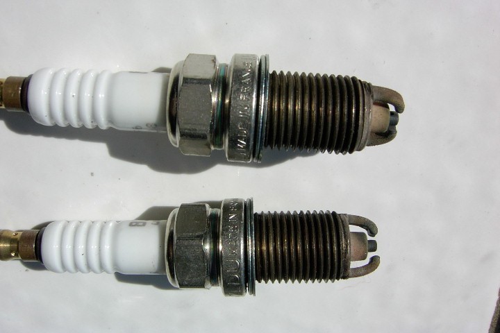

  1. In the past there has been discussion of what plug to use and some concerns were mentioned about the Bosch Platinum +4 (part number 4417). I ran these in my car (1998 Boxster) for the last 30K miles after having run the stock Beru plugs for the first 30K miles. I have attached pictures of both plugs. I did not have any problems with the Bosch plugs. They appear pretty much what I would expect them to look like after 30K miles. YMMV.

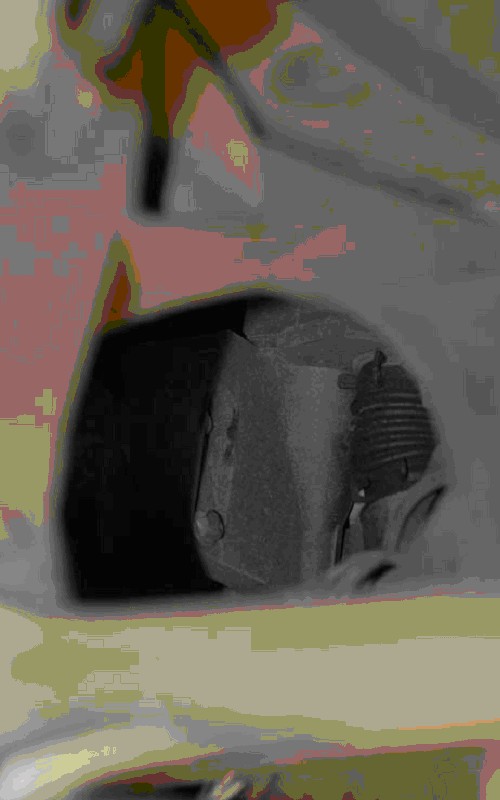

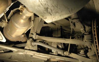

  5. The bellows can be seen from under the right rear of the car. See pics (courtesy Doug Devetter).
