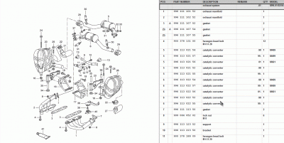

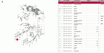

  7. Sounds like you got the opening sizes about right. The horsepower gain from additional outflow could be slight. The sound change would likely be negligible if at all. Does not appear you can use headers for a 2.5L Boxster engine, on a 3.4L 996 engine. Totally different engines and configuration of exhaust. Part numbers and diagrams attached. Good luck. DC

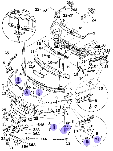

  12. To get the grill(s) out, you have to remove the front bumper cover. Once removed (not very difficult to do)...Then there are just plastic compression tabs on the underside that allow you to pull the grills off from the back. They are easy to break do be careful. Attached is a diagram of what comes off to remove the bumper. Good luck. DC
