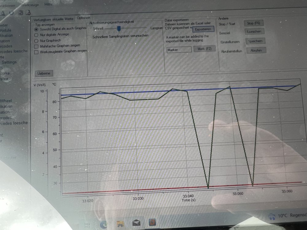

  1. I get that code on my 991-1 with my Durametric after showing up the "Coolant System Warning" in instrument cluster (Yellow). I cannot find out what is behind that code. I changed a temperature sensor in cooling system (behind radiator) because the graph (see attachement) show some implausible reactions, but fault code show uo after a short time again... Some guys said there could be a problem with one or more evap valves? Is anybody familiar with that issue? THX for your support
  2. Just load up a complete graph of the test drive whre you can see the drop of voltage to zero Cooling Water Temp.pdf
  3. Hi, hope that anybody can help me out.. Since a cple of weeks i got the System Warning "Cooling System Fault" (Yellow). I check out for aleak and found that problem on the hose connection located at the thermostat. I fix that but the warning still comes around some times. I dont loose Cooilng Fluid, nor the Cooling System and Oiltemperature rises above the allowable value. I connect my Durametric and found 2 things: 1st: In engine module the Fault code P3300 Implausible Signal is active 2nd: I check out the graphs of different measurements: Cooling Fluid Temperatur outlet (Volt and C°) and Motor oil temperature (Volt and C°) I saw that that the Sensor for Coling Fluid Temperature outlet show up the Temperature steady but the Voltage rises between 0 and 9 Volt (like a sawtooth voltage, see atached pic) - That could be the implausible Signal? Now i am wondering if that could be the Temperature Sensor right behind the Radiator (located behind the left Front Wheel). Part Number is 94860642001. Here are my questions: - Do anybody now the meaning of Code P3300? - Did anybody heard about problems with that specific sensor (because in the porsche part list i saw that an old part should not be use anymore)? Thank you so much in advance for helping me out
