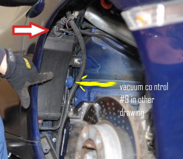

  7. LOREN.. I have the same 99 996 as yours. I am wondering should I be able to blow each way through the line and blue valve in your photo? It is called the Vacuum Control Valve #9 in the diagram above. I am getting po446. When the line is disconnected top and bottom and taken from the canister. I can blow each way through the line passed the blue vacuum control valve. No electrics attached to the line. Should I be able to do this? I expected it to be like a 'one way' valve but mine is not. That fact may be why I get the 446 codde The next time you are in there, could youy please blow through the line for me and let me know the outcome. Thanks in advance.
  8. There is a 'shut off' valve with electric plug on it, top front of charcoal canister which I changed along with the pink valve on top of canister (maybe called purge or vent valve) a double type valve about 3 months ago. CEL still comes on. That's why I am really interested in this blue thing on the side of the canister. It does NOT have an electric plug to it. I disconnected the pipe top from the pink vent thing and the bottom with the blue plastic type round valve set in the middle of this length. I held the pipe in my hands and can blow each way past this valve with ease. I would have thought I could only blow one way as a kind of a one way valve thing but NO. Is the thing GOOD or BAD? Whats this for?. Why is it there?. What is the name of the thing?. I seem to remember someone said it is a 'check valve' but it doesn't seem to check anything only my patience as far as I can tell. I put the part # on google NOTHING. Oh yeh some bloody oil well in Texas somewhere came up. Very helpful lol.

  10. I really need to know the answer to my first message as I am in the middle of smoke machining the evap system. The question being. I can blow air and smoke BOTH ways passed this blue valve. I need to know if this blue thing is good or bad as I think I should only be able to blow ONE WAY not both ways along the pipe. Otherwise why is it there in the first place. What is it supposed to do? THERE IS NO ELECTRICAL CONNECTION TO THIS PART. HOPEFULLY SOMEONE FROM PELICAN PARTS CAN HELP ME AS I AM USING ONE OF THEIR PHOTOS TOP DISPLAY THE PART (BLUE VALVE)

  14. I have a code po446 and CEL up right now. 446 indicates a vent circuit malfunction on the EVAP system. I am trying desperately to track the fault. In the photo you see the black charcoal canister with a green arrow pointing to some sort of blue valve. Its that valve I am interested in. I have disconnected the top and bottom purple and red arrows and hold the line (including the blue thing) in my hand. I am able to blow each way through this line. That confuses me as I wonder now why it is in the line in the first place if I can blow each way. No electrical connection to the blue thing. I would have thought I could only blow one way. Does anyone know what its called and what its there for? Is it a good one or a bad one. I hope its a bad one and then my problems will be solved.
