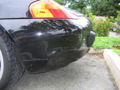

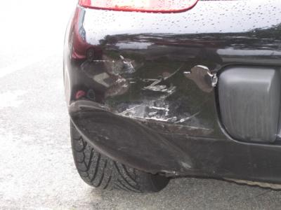

now with pics
some the dent on the lower half of the bumper was caused by her bumper, the scarring was caused by her headlight, and the hole was caused by the sheetmetal of her fender, I can't picture how her bumper went below mine, speed was so low that braking wouldn't have dropped her nose that much and I hadn't braked hard enough to drop my nose either
She braked and it dropped her nose.
Your major concern is to keep the case open until your body shop has time to get inside the bumper and see all the hidden damage to the bumper support structure. In other words, don't sign anything before it is all done that says "this is all they pay".
Also, you have the right to go through your insurance company or hers, even though it is her fault. Whichever seems to allow you to work better with the body shop.
On my web site, I have a picture of my car after a similar rear-ender. Unlike yours, you absolutely can't see any damage unless you know where to look. First estimate was $3k and that included reusing the bumper cover. Insurance wanted to pay off at $1500. To make a long story shorter, the body shop had to go back to the insurance company twice more after they found more hidden damage...and there still was no body or lights work done, the work was all to the bumper and support structure.
Look hard at the muffler too as it is easy to have bent it and there is no straightening it, I ended up having to get a new muffler.
Also, an opportunity to get Eric to redo your bumperettes with painted ones if you'd like. He charged me less redoing mine than what the dealer's body shop was going to charge me to replace mine. And the body shop just deducted the bumperettes charge.

The horizontal crease line of the top left of the damage is fom the aluminium 'bumper' behind the cover - it doesn't look sufficent to jave damaged the bumper bar but maybe worth checking the mounting pieces as they are part of the crash deformation zone.
After that exhaust components, headers and engine alignment
