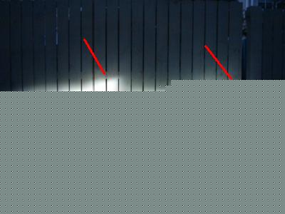

Here's my lights on the fence.
Huh, just like mine. Well there goes that. I have used D2S bulbs before in retrofits and they sucked big time. But considering how well they worked in my situation it's not surprising that these worked so well for you.
Something about the Porsche halogen housing really makes for a good cut off even with the power of HID.. Thats cool and good to know. I have a full OEM 4100k system sitting at my house I didn't even try, ohh well.

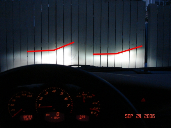

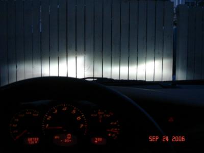

Why is it that the light looks like it is two rights or two lefts? Shouldn't the projections be reflections of each other - the high spot toward the middle, or toward the edges, on both sides?
(sorry about the picture - I'm getting error messages on the upload.)
Edited by Badcow!
I'm not sure if I understand you completely but the pattern should look like that.

Mine look bizarre on the wall like that too, but the halogens looked exactly the same. Thats the stock lighting output for the stock lamp. WHen you put HID in it, it's just over emphasised. When shining on the road however, my lighting is awesome, nice sharp line on the road with the angle up over to the side of the ditch/curb just like the oem halogens did, but nicer light with more power. No glare off to the sides or prolems with on-coming traffic at all. As a matter of fact after 3 months of them now, not a single high beem yet.
