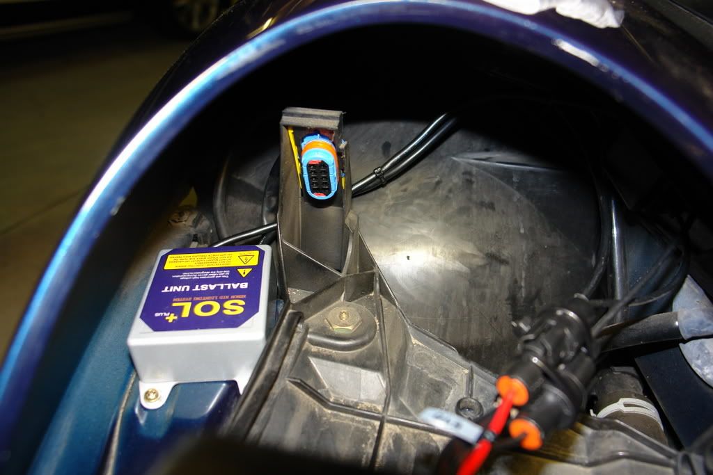

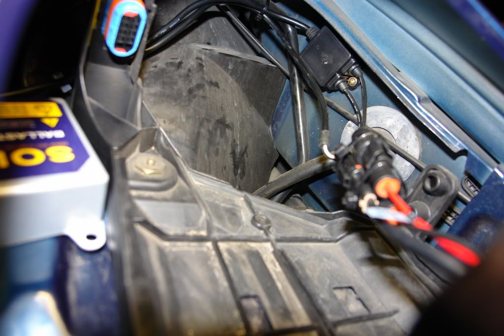

Does anyone have a picture of how they mounted the HID ballast?
Thanks to this great thread now I have fantastic HIDs in my car!
This is how I mounted the ballast...
Share this post
Share this post

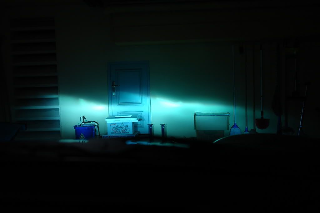

OK, so looked at real litronic lights and couldn't swallow the $1300. I have had HID retrofits in a lot of my cars before but have had mixed results with them. I generally buy a projector housing for the car then put hid in that and even then they are not that great.
I bought this kit from CQ Light:
H7, 5000k http://www.cqlight.ca/index.php?cPath=32_45
They are plug and play lights ment for a H7 halogen headlight. The install was really easy. As a matter of fact the easiest I have done in any car. The headlights pop out with the tool in your bag in the spare tire in about 30 seconds then plug in the HID light, zip tie the ballast in the headlight hole to something so it doesn't flop around then re-install the headlamps. You will need to drill a hole in the plastic cover on the back of the headlamps for the hid wiring to go through. Two wires for the bulb it's self and power and ground that plugs into the stock wiring harness. No cutting or soldering involved. The kit comes with power leads with spade connectors on it already that just slip into the stock bulb socket no probs.
The stock halogen lights have the european code light cut off like this. ____/ if you have ever driven close to a wall you will notice it. I took before and after pics. The cut off was exactly the same with no glare or light wandering away. The cut off on the stock lights is really good and cuts the hid off just like the stock bulb so you only get light were the factory light intends it to be unlike most cars. Generally hid retrofits in stock housings have light all over the place which was the case for me a few times. This is NOT the case with Porsche lights, lucky us.
Just incase you wondered about HID retrofits, you can now see they are just as good as stock. You get the light of HID without 1300 bux. Remember real litronic are better, self leveling etc. so they are worth the money. For $200 you get more light output than stock, the nice HID color, and no downside typical with HID retrofits.
I think that Porsche did a really good job on the stock headlights as they have good cut off from the factory. With a lot more light output from HID lights, they still control the light very well and get it right on the road with no glare.
Bottom line, really good for the cost, and really look nice too.

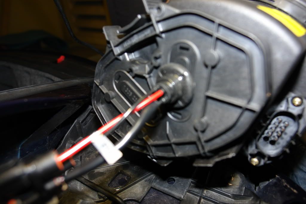

First, for GANDRADE1, it's logical. You need a 1" hole for the big rubber grommet. And I'd advise a little silicone sealant for where the cable passes through. The ballast, with the other electronic dohicky electrical taped to it's back, can be screwed to the back of the removable cover. A few cable ties and you're in. Toughest part is getting the lamp units back in!! Don't plan on finishing too quick unless you have a fair amounts of tools such as files, dremel, assortment of screws and drills.
Hi Bob,
Thanks for the feedback...I finally ordered the kit from CQ and am planning to install it next weekend.
I do have a dremel and a decent amount of drills, etc. The 'bottleneck' for me resides on the skills side... :rolleyes:
That said, do you have any detailled pictures of the install, covering specifically where the wires should be connected etc. I am thinking about securing the ballast with an industrial strength velcro to the back of the plastic cover rather than drilling. Additionally, do you recommend any particular sillicone sealant? Can I get it at a hardware store?
Sorry for the many questions, but any help is greatly appreciated....
Gus

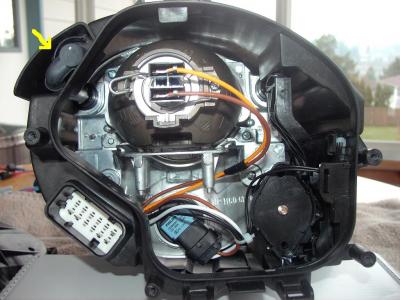

I need help on doing my install.
I actually posted some very very basic quastions I have as well as some pics on the following posting - Simple Questions and Pics
Thank you in advance for your help....

When I installed my HID kit I did not have to drill any holes, use zip ties or anything else, it was very simple plug and play. I used the holes that where already in the car.
I'll get a few pictures taken today and post them here.

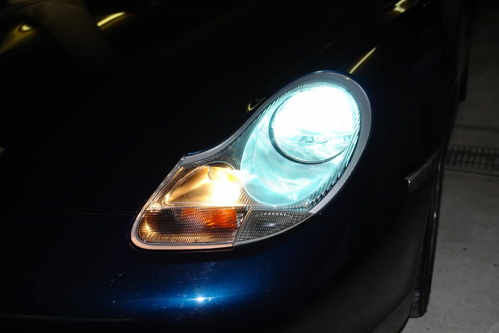

Here are some pics. Notes for each pics are under.
Halogen lights as stock from Porsche.
HID retro fit installed. You can see the cut off is exactly the same on the wall. The car is in a slightly different spot here and it's much darker ouside in this pic making the lights look a lot brigher. More or less the light is exactly the same and in the exact same position.
Halogen light stock.
HID Retrofit with fog on to see difference.
Stock H7 vs. HID H7. You can see the arc point is in the exact same spot. Might be hard as I'm holding the bulbs but they were identical.
Headlights outta the car. 30 seconds a side really.
Stock bulb out. Got kinda hot there wow. HID are cooler running so thats good. The top is the low beem. The HID retrofit goes in like stock. Just run the wires out the plastic cover, drill a hole.
On the front of my house. Same as stock cut off.
HID on the road through the windshield at eye level.
HID on the road over the windshield.
Color of HID 5000k retrofits.
Color of stock halogens.

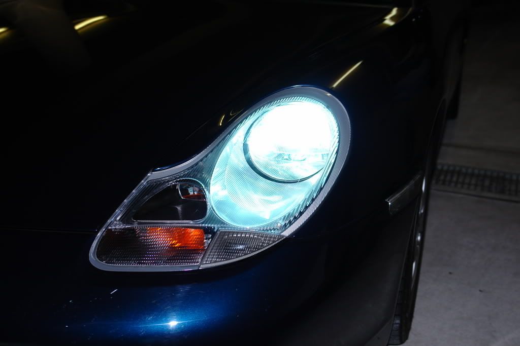

Just got my 6000k hid installed by a local xenon dealer this afternoon for $235(parts & labor). Took about 1 hour. The installer did not take out the whole headlight piece from the front trunk, he jacked up frontside, removed the panel in the wheel section and worked from the backside of the headlight without removing the whole piece. I guess that also works. I am very happy with the result, the light output on this aftermarket hid maybe even better then the original factory xenon I have in my 06 cayenne. (Sorry, I forgot to mention, the newly installed xenon is on the '03 boxster). PROBLEM: I realized there is some yellowish light in my 6000k hid when I see the car from the front with engine running, but when I turned off the engine, the hid light turned off as well and left with the weak yellowish light, is this normal??? I saw the installer took off the halogen low beam bulbs which I have them in them in the box. What is that yellowish light?? Cant be the parking light? Cant be the signal light? I am going back to the installer on monday, please help, I dont want to sound stupid. :huh:
