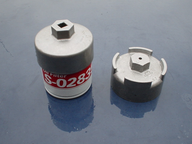

That was the first one I bought, made by Mann. Then I bought one made by Hazet and I can use a 3/8" extension in the end.

You can order the Mann version from any Porsche dealer. I did 3 years ago. Paid $6.56. Part number is 000 721 920 40. There is one on ebay with a current price of $15.50. http://cgi.ebay.com/ebaymotors/ws/eBayISAP...MEBWA%3AIT&rd=1

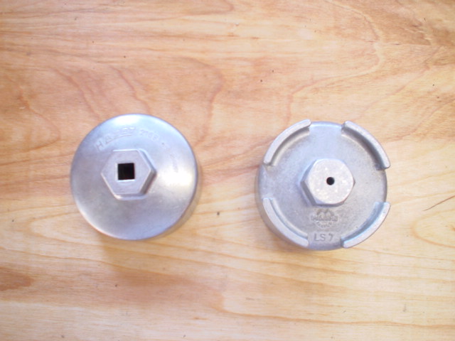

I then bought Hazet 2169 13 months ago which I like better for $17.49 from Samstang Sales and they have one on ebay. Some VW/Audi/Mercedes filter housings are the same as ours so it is seldom you see one listed for a Boxster. http://cgi.ebay.com/ebaymotors/ws/eBayISAP...MEBWA%3AIT&rd=1
You should be able to find the proper sized wrench at any auto parts place or even WalMart for about $4. Most are made of plastic. Ok for the occasional use or if the filter housing was not cranked on too tight. I have seen them break or round off when trying to remove the housing and then I have to get in there with my metal one. If you are going to be doing a lot of filter changes I suggest a metal one.

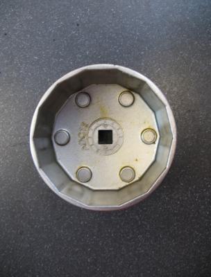

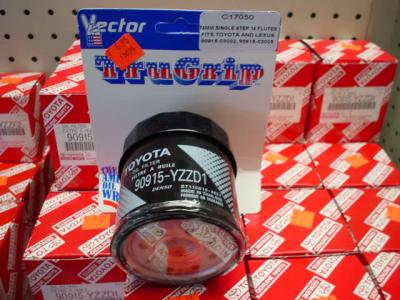

I was at the Toyota dealer to buy a part to fix my horn. There was a display of filters and wrenches on a shelf. So while the guy was finding my part I found the filter for my truck and the wrench that fit it. The wrench was 74 mm with 14 flutes - same as my Boxster. The brand wrench Toyota had was Vector and it is made of metal.
Never knew the Toyota and Box used the same wrench, as I always used a strap wrench on the Toyota.
When I got home I took my extra aftermarket (made by STP) Toyota filter and tried the 2 wrenches I use for the Box. Both fit.
Now I can use the same wrench on the Box and Toyota....
