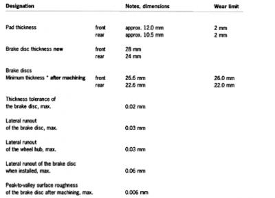

Here are the numbers for Carrera 4, 996. However when in doubt replace them as New Rotor's can be found for around $100 online.

Checked them today - fronts are 27mm on the outside edge and rears 23mm - hmmm, guess I need to change both ... :-(
