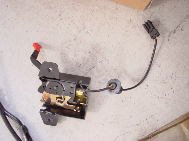

you have to remove the black plastic cover over the hood latch, there are 4 plastic screws that hold it in place. Then you can remove the hood latch unit by removing the 2 bolts that hold it in place which you can get to by lifting the trunk carpet. The rest is pretty self explanatory. Detach the hood latch unit from the trunk pull line and when you open it up you will see the sensor, it is a white button. I have changed the latch on my 99 996 and noticed that the sensor was not the culprit in my case, but rather a worn out piece inside the latch.
Most common is that the storage box lid is not closed. Next is the microswitch in the front trunk latch. Porsche changed the switch in 2000. If the switch is bad the trunk light will not go on, go off, or the alarm horn will beep. You can buy just the switch if that is what it is. At my dealer they just the entire latch.
You can see the wires to the switch.
