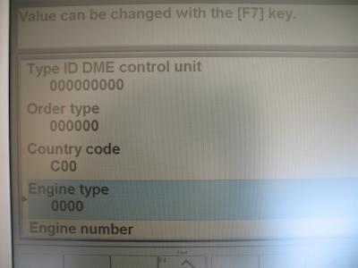

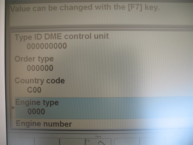

Peter replaced the DME on my 1997 last year. But before it was replace I got a printed log of all the data in the DME. My order type (986310 for my US car), the country code, engine type, engine number, and so on. It even had my radio code on the print out that I had added to the DME a few years ago with a PST2, because the factory had not entered it.
So, the new DME had a bunch of zeros. Peter entered my VIN. I asked him to also enter the radio code. Nothing else was entered.
That is why I have even more zeros than shown in the pic.
So, today, I look at the DME data. My order type is now 000000, since Peter did not enter it when the DME was replaced.
Maybe I should enter 996620 for the US 996 turbo.... :eek:
I guess that would be 996621 for a UK turbo.

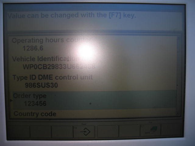

Played around today with my 1997. With 000000 as the order type I was able to turn the OBC off/on. I then changed it to 123456 and was still able to turn it off/on. So the 2003-2004 wants an order type, but this does not matter on my 1997.
I always wanted a Carrera GT, which is 980. I did not know the last 3 digits for a Carrera GT so I guessed 100. I now have a 980100....

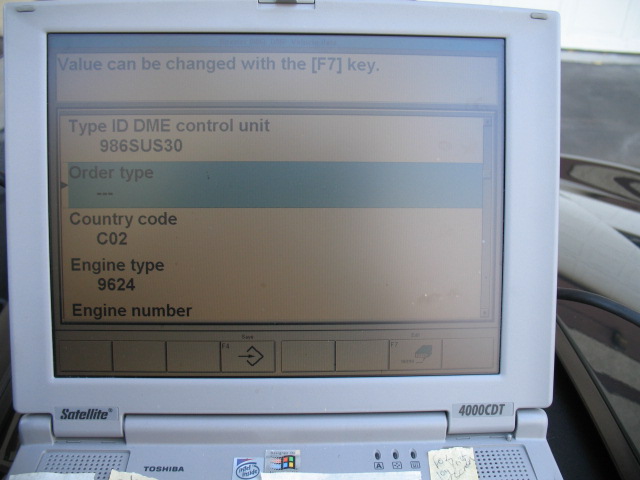

I tried the 123456 on a 2003 S today, made in Feburary 2003. To make it ready for an OBC and cruise control retrofit.
As predicted, the DME did not have an order type, just 3 dashes ---. So I was not able to get to the instrument cluster "modify coding" screen. Instead, it asked for the order type.
Put 123456 into the DME as the order type and I still could not get into the screen. Then I put in 986320 and everything worked.
So much for that experiment.
