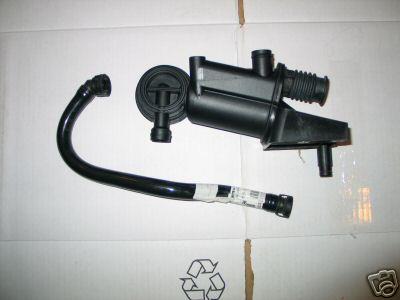

This is the new design that was on ebay. Peter said it is just 2 bolts but they are hard to get to. You also need the hose or J-tube that goes to it. Your profile says a 1998 so you have the old horizontal style.
