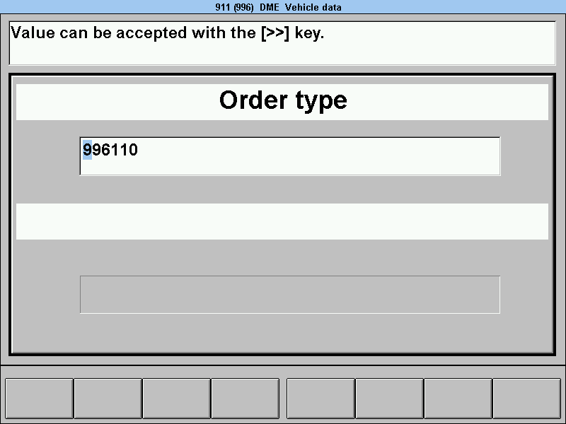

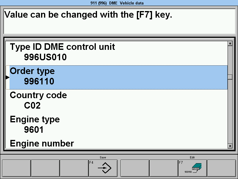

It is actually called order type and get to it by going to Vehicle Type (Boxster (986) then to DME -> then to Vehicle data. Then scroll down to (and highlight) Order type. Press F7 to change the order type to 986xxx (yours is likely blank).
xxx being:
310 is normal Boxster (986) for USA
320 is 986 S car US model
330 is 986 Anniversary US model
Press F12 to confirm the change.
(these are from my 996 - but you get the idea)
You will need to disconnect the tester - turn the ignition off. Then reconnect everything and set the cruise control on in both the DME and instrument cluster. Done!

Ohio Valley Region PCA had a tech session yesterday at one of our Porsche dealers. The Porsche tech was nice enough to try your instructions on how to turn on the cruise control. He was skeptical that it would work. After trying it wrong the first time and then following your instructions, step by step, he was able to get into the part of the program to turn on the instrument cluster. We got a cruise control indicator light to come on and after taking a test ride, the the cruise worked perfectly. I want to Loren for his help getting this cruise working. If I couldn't I probably would have sold the car and looked for another. Thanks again to Loren and the technical forum.
