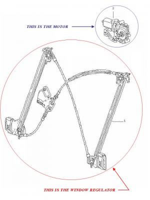

From the Porsche Catalog the show the following: http://carboncow.net/php/gallery/view_phot...986_USA_KATALOG
I am under the assumption that part #2 which is the motor and regulator assembly is what I need and they are sold together, you cannot get the motor seperate even if you wante too!
YOu speak of getting the regulator assembly and rails, while in the Parts Catalog the rails and cables are clearly part #1.
What in fact did you order and get for $150?

I did ask for quote from Sunset today. Can you clarifiy from me what you got as I so confused on what everyone is calling a regulator!
part # 2 is the motor (which you do not need). part # 1 is the regulator. the regulator is usually $150 to $200 depending on where you buy it. you can get a used one from german auto dismantlers for around $85. there is a green plastic piece on your old regulator that is kind of near the left hand #3 in the link you sent. you will need to be sure to move it to the new regulator (if it's not already attached) when it arrives. it sets the window drop height to the boxster rather than 996 setting.
OK I get it, the catalog is just misleading...they should have seperated the motor from the black box if they are giving it a unique number.
If you guys swear the regulator tranmission housing (black box) comes with the rails and cables, then that is what I'll get! Another state $150 from Sunset

they are separate; not sure how you're looking at the pic. see attached image.
OK I must be an idiot then as now I'm back to confused. The catalog shows the same image you have posted.
The part you have circled as the motor is infact the motor and regulator tranmission (black box) assembly combined, the motor is simply the silver part on the end. Inside that tranmission assembly is what I have been lead to believe is the problem as stated in this post:

The oval-ized bushing holes ARE IN the black box, correct?
If you are stating that I need the window regulator (cables and rails) then what is the failure trend that causes my issue of the window not going down a 1/2 inch when the door is open?
If porsche simply seperated the "black box" from the silver motor I think this would be less confusing for me!

you are very confusing indeed! don't worry about bushings or holes. what happens is that the cable for the regulator frays and binds in its protective sleeve. when the motor tries to roll the window down 1/2", it basically just unwinds some slack (from the defective cable) and the glass doesn't move. this is a very common problem. your motor assembly is fine.
