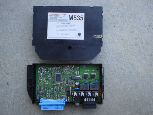

It is the electronics in the control unit. Not the switch, and there is no relay for the windows.
The windows run through the control unit under the driver's seat. This unit is also for the "comfort" features, the alarm, and other stuff.
1997 was the first year. It is an odd year. I have a 1997. You cannot even get a new 1997 remote key to work with a 1998 control unit.
I went through this about 6 years ago with Peter Smith on my car. Too expensive to get the one-touch up on the passenger side.
But I did buy a used 1999 control unit on ebay. One of these days....
