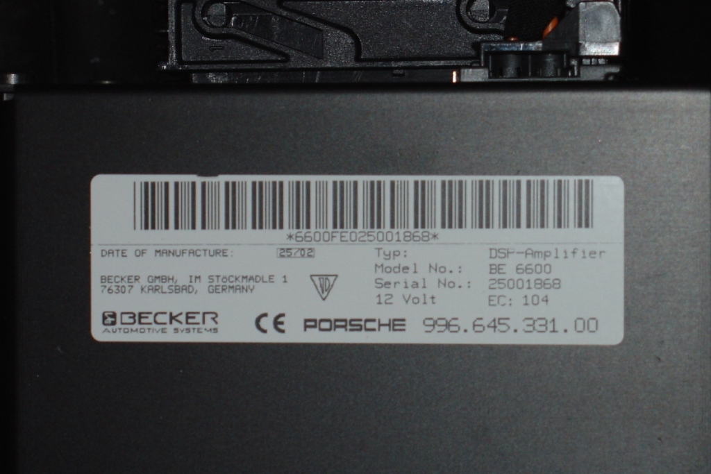

If you have a Becker BE6600, this is part number 996.645.331.##. It is a fibre optic, 6-channel amp. Like this:

If your installer thinks this is a 4-channel amp, perhaps they pulled the pins from the door speakers (positions 7/16 and 8/17) and plugged your rear speakers into there. (?)

q-ship, thanks for the photo, yes it is exactly what i have becker be6600 in my 2003 boxster. what if you are right, the installer pulled the pins from the door speakers and plugged the rear speakers into there, but why i can still hear the bass from the door?
Well, I was just offering a possibility...I didn't know you still have bass from the door speakers. I guess we really don't know what the installer did.
At this point, I would take the above information to your installer, or check into it yourself, and go from there.
