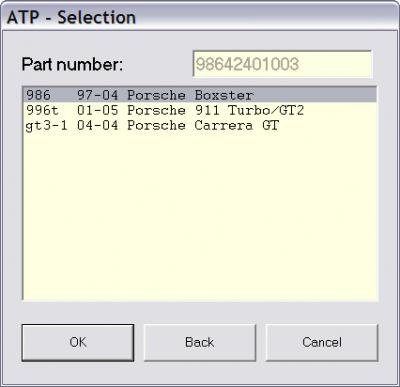

Part #986 424 010 03
What models does this assembly fit? Is it EVERY one of the 996 line?

I assume 97-04 Boxster "includes" 996 as well? I do NOT see any 996 other than 01-05 TT and 04GT3.

So then the assembly application is EXACTLY as you posted the picture of nothing more nothing less? Only reason I ask is that it appears that the B&M SSK itself is for ALL 986, 996, and the 05 997 models. I guess the stocky assembly that holds the shifter is what is different.
97-04 Boxster
01-05 996TT
04-05(?) 996GT3
I just want to make sure that whomever I give this assembly with the B&M SSK already in place gets the right part.
I do not know the differences. Jeff (Tool Pants) and I have looked at many of these and we can not see anything different. If there are differences they are very subtle. Together we have likely installed several dozen B&M SSK kits and they have worked on all versions of the factory base shifter.
