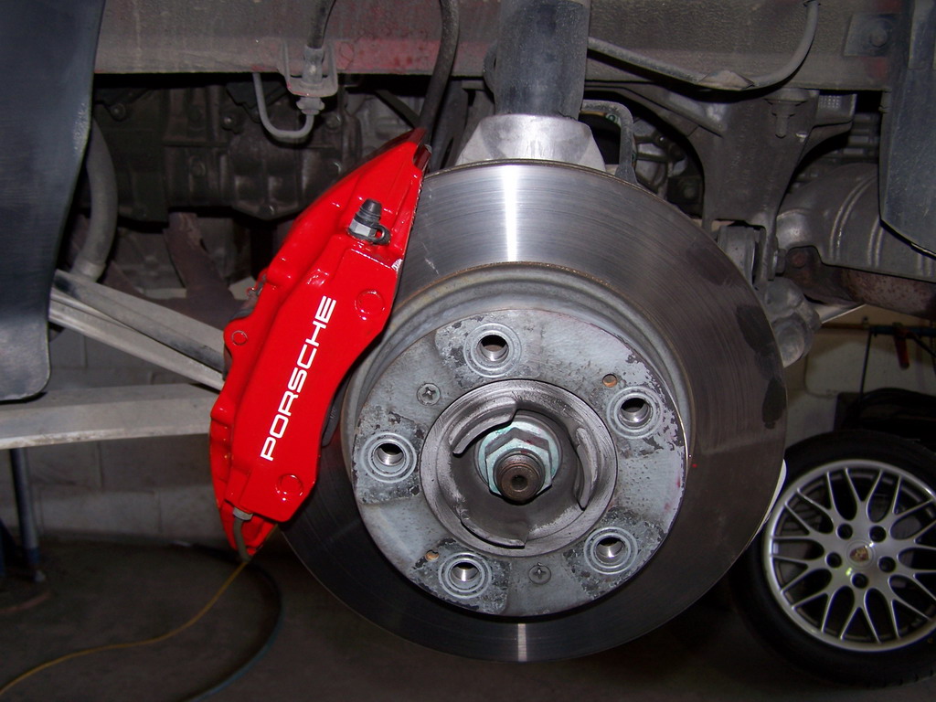

OK I have since done this and decided I would update this thread.
I used this: http://www.duplicolor.com/products/caliper.html
It's a brush on ceramic caliper paint. It took 4 coats on each caliper to really get them solid looking. I didn't have to mask anything and the paint dries really fast. I had my car on the hoist, pulled off all 4 wheels then just walked around painting. After I did all 4 calipers I could go back to the first one and it was already dry again ready for another coat. Dries in 5 mins to the point where you can touch it. I just kept walking around till it looked good, and 4 lap later here it is. I also put on the xenonmods caliper stickers from Ebay.
It was streaky at first but once the paint was a few layers thick and it drys it completely smooths out. I have things powder coated all the time for my business and I swear this looks just as good.

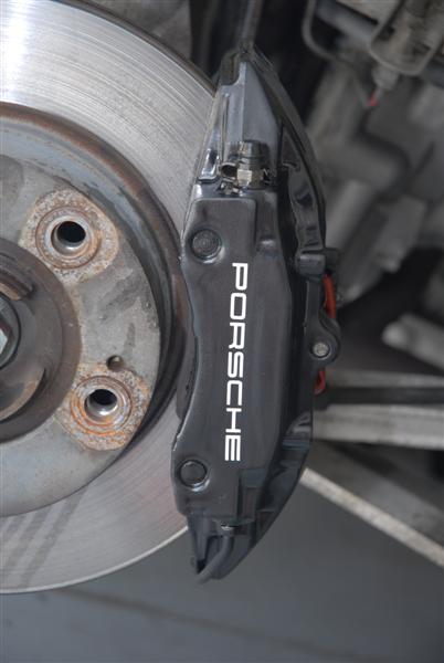

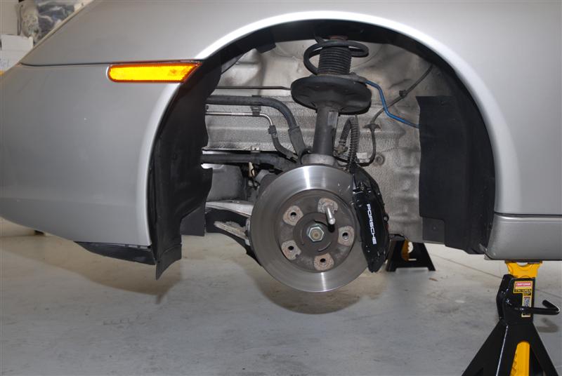

Just finished painting mine. Took off the calipers and cleaned and taped them off before paint. Cleaning took 90% of the time. Could be the Sam Adams slowing me down or just old age. Anyway all went well except dinged the drivers front caliper putting the wheel on. Dumb me!
Looks great, I like the black on your base Boxster.
Yea Yea, I told my wife i was going to paint them Red then she said "But your car isn't an S".
She isn't the sharpest tool in the shed, so if she knew then....
So i painted them black.
