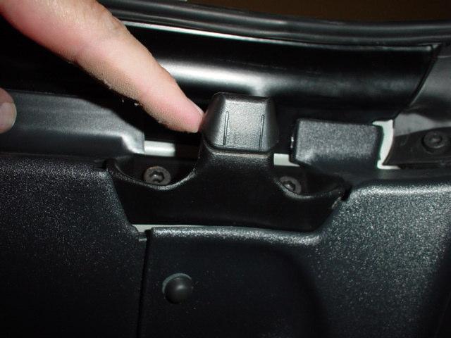

i don't think the guide pin can be adjusted at all.
the hardtop position can be adjusted somewhat by loosening the bolts located under the triangular cover, then tightened when the top is in the position you like.

My guess is that you need to move the opposite rear of the hardtop laterally in orer to close the gap at the windshield using the adjustments described by Chris.

the spin locks look fine. I think the trick is going to be losing the those allen bolts and torsionally twisting the top forward to get it to mate better. We are going to look at it in the shop today, I'll post the out come.

You should also check to see that the centering journals have a plastic cap. They like to pop off.
Is that DVD for members or for sale somewhere?
My caps have been removed and looks like the TSB ones install, in is chewed up and we removed it hoping it would allow the journals to seat in furthur with little luck. We adjusted the allen bolts today with someone pushing on the back and this didn't close the gap like I hoped so we are scratching our heads now. The left side is easily 1.5cm away from the window compared to the pass. side.

Anyways I had one guy push really hard on the back toward the front on the left as I cranked down the adjustment bolts. looks liked I got another centimeter of closure on the gap. At the same time I don't feel the wind intrude into the cockpit so the sound may be turbulence created by the fact the drivers side peeks a 1 cm high above the windshield then the other side.
Rather strange there appears to be no adjustment to height at the guide in at those to bolts to adjust its movement in any direction. Porsche has lots of faith in their fit finish of this product! Maybe a Porsche tech bent and grunted this top to the previous cars fit due a flaw.

does anyone know if the two receiver pin bolts allow for any up/down motion of lining the top to the windshield.
