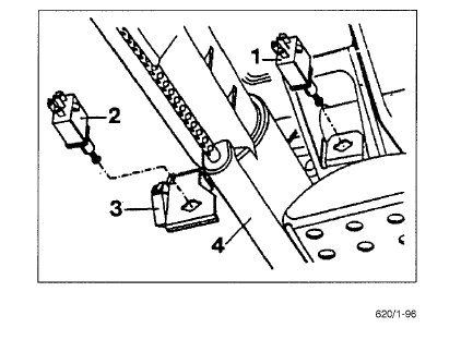

I'm not 100% sure as everyone is telling me there should be a switch there ! But I have had a pretty good look without dismantling the dash and I cannot see one. The car does not have cruise control and I can see the location for that switch and the unused harness to connect. Anyone have a picture of where it is located ?

If you can see where it should be mounted and the harness, then it sounds like the switch is missing just replace switch and go from there.
