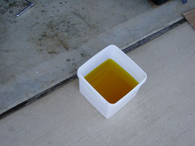

Kind of OT, but what do you do with old coolant if you are going to change it, can it go down the drain??
Us cheap Boxster owners send our fluids to Texas to be recycled. :D In San Jose we recycle and have carts for paper, metal, and so on. We get plastic jugs for used oil that we leave on the curb for garbage day, but not for coolant or brake fluid, but there are places you can take that stuff to. In San Jose the sewage treatment plant does not like chemicals in your drain water.

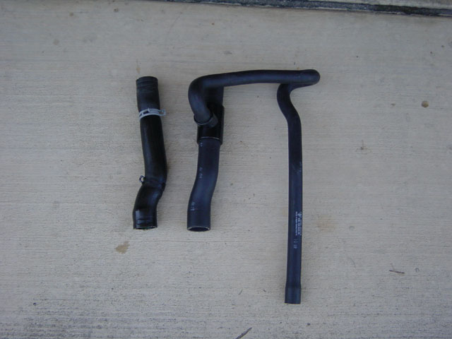

OK, let me make sure I've got this right.
On the passenger side the LOWER radiator hose is replaced with the simpler of the two new hoses, and on the driver side the UPPER hose is replaced with the more complex new hose. Correct?

Yes the hose with the longer small hose goes on the drivers side top.
(upper hose drivers side - old hose left new hose right)
