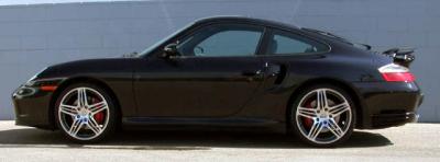

I am wondering if it is a wise decision to fit the 997 TT wheels on my 996 TT....
I know that I should use spaces to the rear axle and the tires must be 315/25/19..... :rolleyes:

I have my car with 19s, with 235/35/19 and rear 315/25/19
are the turbo 997 wheels a direct fit to the 996 turbo, or do you need spacers or anything?

I purchased a set of 997 TT wheels to mount on my 996TT. As soon as I removed a wheel from my '03 turbo (hollow spoke) and went to mount a 997TT wheel, I realized how much heavier they were. When I put one of them on a scale, it was at least 8lbs heavier. I forget exactly, it may have been 10lbs. I then sold them and went to a light aftermarket wheel. If performance is not a priority, they can be considered. Otherwise, look elsewhere.
