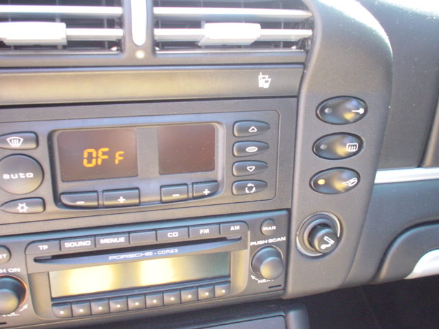

Well...Awhile back i was fiddleing with something in my car and droped something hard on the glass readout of the climate control. At first it just had a little bleeding on the glass, but eventually it got out of control and the display would flicker and was completely unreadable! Well, it finally bugged me enough to look into fixing. I called up suncoast and they wanted charge me about $400-500 for a new unit.....that wasnt going to work. So i went with option B. http://cgi.ebay.com/ebaymo

MANUELL is gone. But what happened to OF f?

LOL... i have not investigated the OF f yet, although that cracks me up every time i see it. I'll take a pic, maybe tomarrow. As far as the boxer guys having trouble, i dont know what to say, it was "mildly" difficult, but nothing impossible. It was no harder than the install of the short shifter ;). I have gigantic fingers too...so if i can do it, anyone should be able to.

Well. I would have lost that bet, I couldn't get that segment to work, and when I took it apart the LCD had a slight leak. BUT, the new unit from Circuit Solutions for the Boxster/996 now fits perfect with no hacking at all. I had the new one in in less then 45 min and it is ALMOST perfect in every way. FWIW it now says MAN..instead of manuell, but the OFf is still therel! The other issue is that it is perfect viewed head-on, but loses a little contrast when viewed normally from the drivers seat. The oem does not have that kind of parallax issue.

This defect is also called the Sundown, Sundowning, or Sunrise effect. The fix was pretty easy. The LCD fit in the metal "cage" without any modifications.
While I was at it, I fixed the LCD in the Radio, which was also failing. (Why can't Porsche make a decent LCD). The CR-220 radio head unit in my car was given to me by a friend a few years ago, because my head unit had peeling buttons. I did the swap, but saved the old unit, peeling buttons and all.
Fast forward to today, and the LCD on my "new" unit is failing.
So, I took apart the faceplate, swapped the LCD screens, and re-assembled. This fix DID NOT WORK. The failed LCD segements were in the same place with the swapped LCD screens. So, I figured it must be a different component. I took it apart again, and swapped the electronic board behind the faceplate. That worked!
Now I have two functioning LCD screens. :thumbup: The Climate Control LCD doesn't look "stock" anymore, but at least it works.
