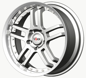

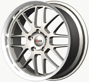

Hi guys,
I am starting to explore the idea of buying aftermarket wheels rather than the OEM 16s for my winter set... Does anyone know the offset of the wheels I should be looking at? Any idea of good places to look for.
I have a 01 (base) Boxster.
Thanks,
Gustavo

Almost impossible to find a set of after market 16", they just don't make em. When they do it's usually OEM replica but I've seen some 17"s
