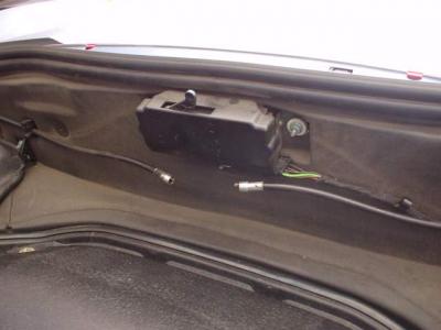

The switch is part of a metal frame assembly that surrounds the electric motor. When the top is almost completely open, the clamshell presses on the switch as it completes its cycle and the convertible top control module (double relay in the footwell) then sends a time-delayed signal that turns off the light on the dashboard and simultaneously cuts power to the electric motor.
Here is a photo that I borrowed from Tool Pants that shows where the switch is located and what it looks like:
The issue is that the early Boxsters had this switch, but the later ones did not. I am not sure which year was the cutoff year for that switch.
Regards, Maurice.
