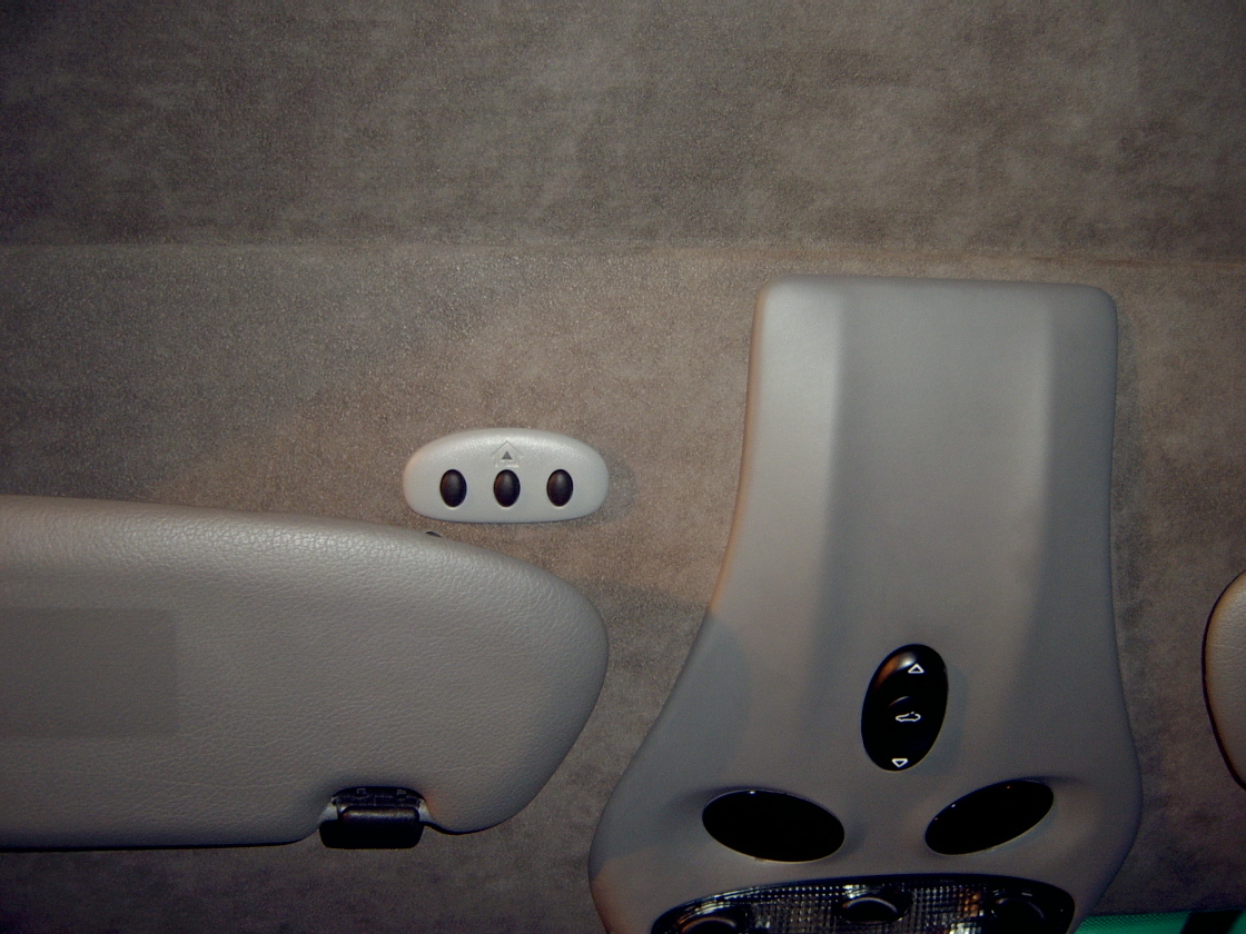

Okay, so I did it...all done and I'm pretty happy with it. It was not easy getting in there and mounting it though. I used double sided tape, and there is not a smooth flat surface, so hopefully it stays there well enough, cause it's never going anywhere else.

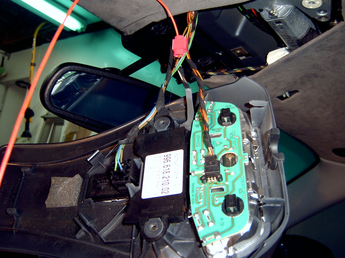

In the picture below, you an see the wire I spliced into. It is switched power that will stay on after you shut off the car as long as the key hasn't been removed. It's brown with a green stripe (at least on my '02 TT) and it the power wire going to the sunroof switch. Only thing I noticed is that sometimes after you shut off the engine, it may not get enough power...but it works great for any normal use (while the car is running and shortly after you shut the car off- my issue also may have been because I hadn't driven the car and I'm sure my battery was lower than average).

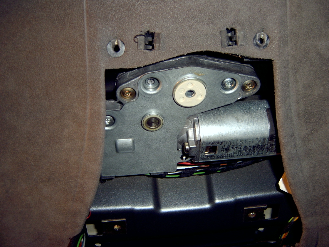

In this one, you can see what I used for ground. The screw that is missing, is where I attached my ground wire.
Here is a not so clear (due to space) picture of the homelink mounted above the headliner. You can see that it only mounts on part of it. It's so light though, that this should not be a problem. If I had to do it over, I would probably try it with heavy duty velcro so I could adjust it to be straight without starting over...(wasn't easy and my arm is all scraped up.
Look! All done and how pretty is that! I absolutely did NOT enjoy cutting my suede headliner that I'm sure would be costly to replace had I screwed up. I am happy with it and it works great, and looks like it came stock that way. [You can also see the bad luck I had in removing the ugly airbag sticker...still shows there, and the other side is worse, as I used goof off and it ate away the plastic on the mirror. I'll have to get new visors at some point that come w/o the sticker.

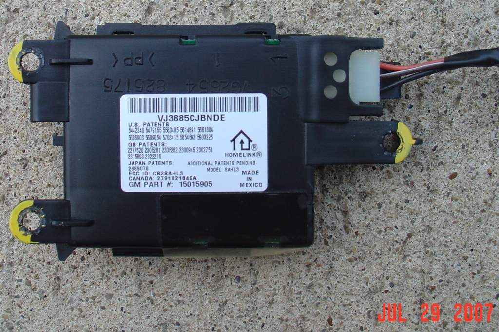

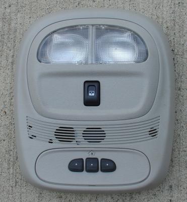

The number of wires and what they do depends on the homelink unit. I am finally installing a homelink in my 986, using a unit harvested from a GM overhead console. This particular homelink had three wires:
black= ground
orange= +12VDC
brown w/white stripe= switch/button backlighting
I like the solution presented in this thread, which I originally considered, but I don't have the headliner. That lead me to my current endeavor.

No, you have nothing to fear/regret. The device you bought does not have backlighting built into it.
I pulled a homelink unit out of a GM overhead console. It is a different module from yours. The console had buttons that were backlit by tiny blue-covered bulbs inside the homelink device. See below.
I scoured the internet and determined that there are many variations of these devices, depending on their vintage and original installation. However, I noticed the ground and +12vdc connections seem to be the same from device to device, but don't hold me to it.
