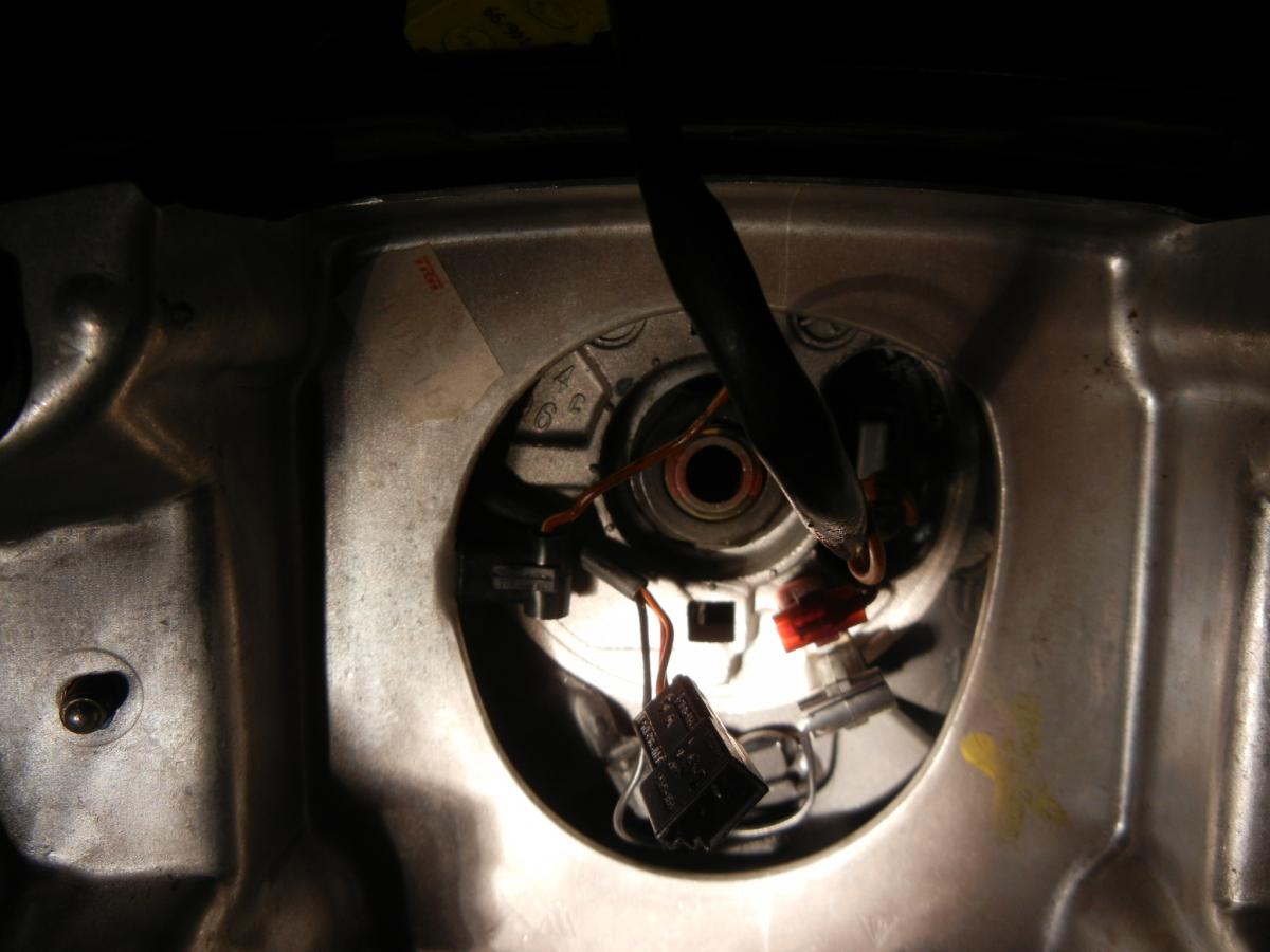

I just bought a Boxster 2000 and my horn doesn't work. The horn sounds with the key fob but not when pressing the horn center of the wheel. But, whoever had it before me had swapped the manual transmission horn for a horn from an automatic transmission car so I have the triptronic buttons on either side.
When I pull the airbag I see the yellow plug for the airbag and I see another black plug with two prongs inside coming from the left side of the wheel. I also see a plug with a thin black wire plugged in near the bottom of the wheel, a brown wire plug plugged next to it both on the lower right quadrant. I have a black plug at the horizontal 9:00 position (middle left side connected to the bracket).
First question - will the automatic steering wheel connect electrically on the manual transmission car and the horn work?
I can remove the bracket with no harm/if I remove will I have to rebuild the bushings?
Second - does any one have a color picture that shows the correct wiring routing?
Third - how do I test the bushing issue as related in this forum - they seem pretty stiff to me as I cannot not seem to press them.
I have included pictures of my situation - hopefully someone has some ideas.
Thanks so much,
--Joe

Perhaps a short? There is a plug in the horn/air bag area. Have you removed the airbag module/cover from the steering wheel and checked the connections? Not to belittle but make sure to follow the process well documented here.
Also - do you mean the horn beeps when you lock the car or does it work when you press on the horn without the key on? If beeps when you lock then something is open - trunk, hood, console, after market radio, etc. AND the alarm system uses a different horn.
If works without the key when you press on the horn and not with the key when you press on the horn I would suspect a disconnect or small short.
