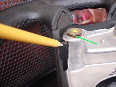

The green line is to one of the 4 bushings. My pencil is to one of the 4 horn contacts. When the bushings become worn and relax the frame/metal plate makes contact with the horn contact due to the weight of the air bag, and beep.
Porsche does not sell just the bushings. You have to buy the entire frame. Some guys use slices of garden hose to make the bushings stiffer. Someone else put a spring under each bushing.

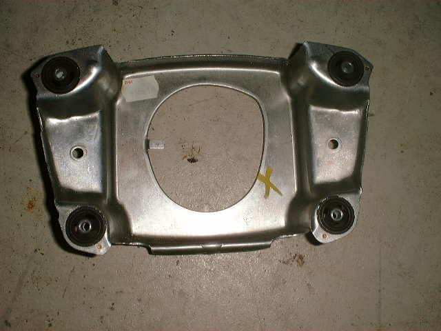

This is the 4 spoke frame. Part number 993 347 088 01. Retail $65.

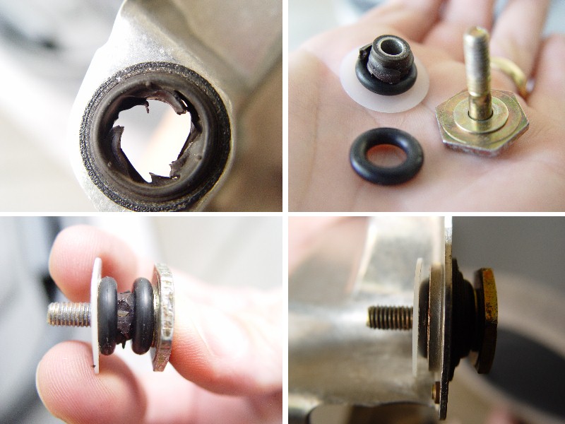

I had to fix my horn earlier this summer as it was stuck in the on position. This was discovered when I replaced a fuse – the boxster’s horn are loud in a confined area when not expected.

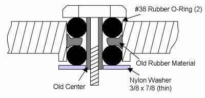

The following image shows the basic concept of how I fixed the horn. The o-rings and Washers were purchased at ACE. The o-rings are made of black rubber and I believe are a #38 size – not positive on size number. The washer is made of white nylon and is 3/8 x 7/8. I used the thinner of the two washers that were available in the above diameter.
I removed the old center parts of the rubber piece that was in each of the 4 holes since these were about ready to fall out from deterioration. You need to hang onto the old centers as they are used in the fix as shown below. I left as much rubber attached to the frame as possible as this is what holds and locates the frame between the o-rings. I added a nylon washer to provide some extra clearance between the frame and the contact. I had to tack this washer to the nearest o-ring with a small drop of super glue so that they would stay in place during the assembly to the steering wheel.
This fix results in a stiffer horn so it is more difficult to toot the horn with you fingers. The horn does work when needed and does not bounce on the contacts.

I had some extra time over the weekend so I took some pictures of the fix for the horn covered in the earlier post. The o-rings measured .300 x .580 and .140 thick. The nylon washer measured .375 x .875 and .031 thick.
The image below shows the hole after the center is remove, the components partially disassembled, the components together, and the components assembled to the frame.

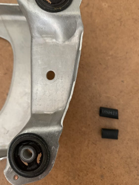

Easier fix is to fill the rubber bushing completely with Black hi Temp silicone gasket in a tube available at all auto parts stores. It dries hard and returns the horn to normal operation.
  • Upvote 3
Share this post
For those with the horn problem, I wanted to steer you towards the black hi temp silicone repair. I tried going to Lowe's, Home Depot, and even Ace for the o-ring solution suggested by jporter, but could not find an o-ring #38 or nylon washers of the right spec. Very frustrating. When I took off the airbag, I found that my rubber bushings were all still in place! This intrigued me because everyone else's had tears or even torn all the way through. Nevertheless, the silicone fix has solved my horn problem, and I conclude that my rubber bushings, though still intact, had become exceptionally flimsy, and unable to offset the airbag's weight. Good luck to others with this problem.

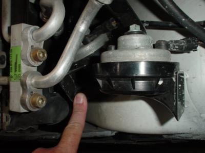

If you can hear the relay clicking then it "sounds" :lol: like you have 2 bad horns.
Usually just one goes out, and it is usually the one you can see through the opening in the bottom of the bumper cover because that horn exposed to water. The other horn is mounded differently inside the cover so water can't get to it. You can see both horns in the picture. My finger is pointing to the one that usually does not drink water.
But, maybe you are the lucky owner with two bad horns.
