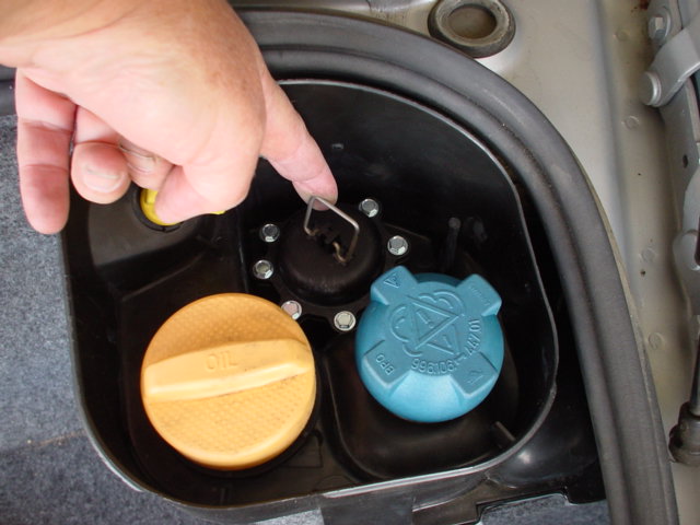

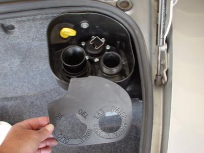

You need to cut the connecting web to get the old gasket out. http://p-car.com/996/diy/waterpump/
Remove the caps then the plastic plate under the caps. To open the bleed valve you lift it metal lever up and it will stay in the up position.
Lift up on the lever. Warm up the car a while and keep the tank full. Put the cap on run the engine at 2,500 rpms for 10 minutes to get the thermostat opened. Make sure the tank is still filled. Run the car at 2,500 again for 5 minutes and every 30 seconds briefly rev the engine up to 5,000 rpm. This is for a manual transmission car. Tiptronic has a valve that needs to be opened.
All this is for a car in a shop setting. When I bled my system at home a few years ago I filled the tank. Put the cap on and lifted the lever. Then I went for a 20 minute drive. I brought water with me in case the low level warning light came on to top off the tank, but it did not. When I got home I filled the tank to the max and closed the lever.
Don't burn yourself.
thank you very much..I appreciate all the tips and the time you took to answer all of my questions...still waiting for the parts i need..once i get it(hopefully tomorrow) I can start putting things back together..

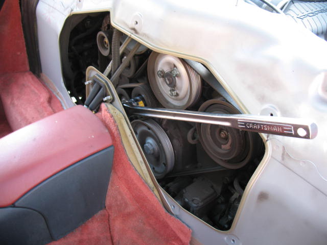

Hi,
This is my first attempt to do a write up, hopfully this can help some people out. Here are the tools that you need:
1. hose clamp
2. spring-band clamp pliers
3. Torx socket
4. flexible head socket wrench
First, you need you to remove underside panel to get to the coolant hoses. Then clamp shut coolant hoses with hose clamps.
Then, undo drain plug at water guide housing and collect coolant.
Next, undo pring-band clamps with pliers.
From the top: the shop manual says to remove the right hand seat, which I did not do, but I think you will have more room to work around.
Then, remove service cover at passenger compartment rear wall. To do this, first remove rear-wall lining, then undo 9 hexagon-head bolts (10mm) and remove cover.
Those with the drive belt in-tact, need to remove the belt first, my belt was destroyed by the water pump (1st pic), so I skipped this step.
After the belt is off, you can now take off the water pump using flexible wrench, socket is 10mm. There are 7 nuts in total if I remembered correctly, and the bottom 2 nuts I managed to get it off from the under side. ;)
After all the nuts are off, take the water pump off, and remove it. You can see in the pic that mine is very very broken.
From here, install is just the reverse, make sure to put in the seal, otherwise it will leak. Put everything back and fill up the coolant see if it leaks ( if you have tools to pressure test it, even better!) drive around and let the bubble out, fill up, then you're done! :D B)
make sure when you put the belt back, put belt in in this sequence: water pump, alternater, intermediate roller, power-steering, air-con compressor drive pulley, crankshaft, idler roller, then over the tensioning roller. Make sure you use correct socket size for your size, 2.7 uses 24mm, 2.5 uses 19mm.
