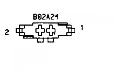

BTW - there is a bundle of wires that go into a 2-piece plug. The top piece has 2 wires - I found out this goes to the trunk light. The second piece of the plug was the piece that was previously disconnected and appears to be for the spoiler.
However, there is a third 2-pair cables that goes to a connector that has plus sign (+) type of shapes on the end of the connector - as in looking at the plug's end. I wish my camera worked.
I'm not sure what this is supposed to be plugged into. It is just lying there and I can't find anything needing the male end of a connector.

BTW - It is connector B02A24 - See Below

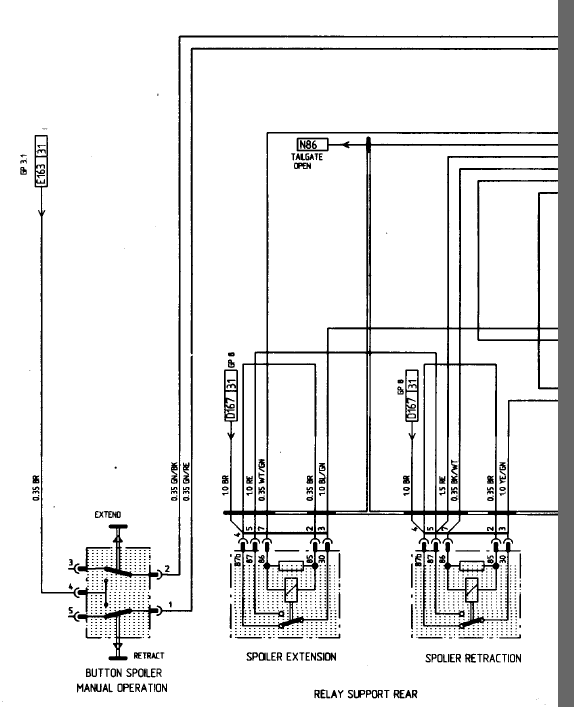

I looked at the wiring diagram last night and noticed that there was something about "Tailgate open" which is numbered N86.
Anyone know what this is for? OR if could this be part of the issue I'm having?

I also printed off the diagram from my Bentley. I did notice on the diagram there was something shown above the Left Spoiler extension relay called "TAILGATE OPEN" and labled N86.
Anyone know what that is about or where to physically find it?
In this case...
30 = unswitched power
K76 denotes which is 76 on the left hand margin and K on the top margin schematic location (in this case it is on sheet 8 of the schematics - which is most of what I posted above)
31 = ground
M78 denotes which is 78 on the left hand margin and M on the top margin schematic location (in this case it is on sheet 8 of the schematics)
thanks guys!
Will:
From the diagram that Loren posted, it looks like the mystery connector is the one that goes to the "Tailgate Opener", as that one in the diagram shows the exact wire colors that you describe (i.e., a red wire, and a blue wire with a black stripe).
