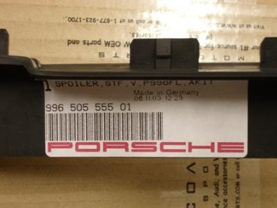

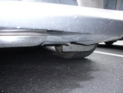

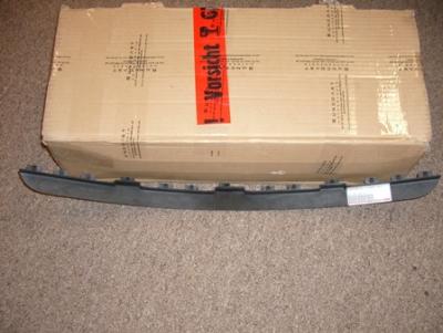

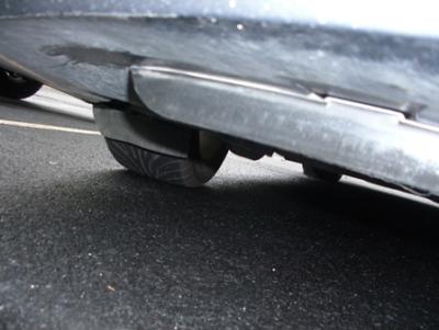

Update
I ordered the following part:
996-505-555-01 which is apparently the front lip spoiler for the Carerra Aero kit also know as the Aero Cab kit.
It is a direct install into the underneath of an 02 bumper.
Turns out I already have one of these on my car :oops: :cursing:
Here are some pics of the part.
