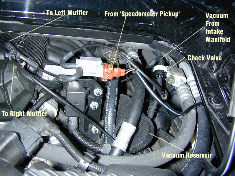

I have a problem in locating the Check Valve. In my 04 4S the vacuum reservoir is mounted much more to the front of the car. The vacuum lines to the mufflers run to the back, where they are split to the left and right muffler. One vacuum line which i guess have to go to the check valve, runs behind the engine ( towards the front of the car ) Question, where does each side of the check valve go ?

The gray item in the center of your picture is the solenoid. If you follow the black vacuum lines one should go to the check valve.

Looking at that picture, one side of the one-way valve is connected to the inlet manifold and the other is connected to the vacume reservoir and the PSE muffler valve.
I think reversing the one-way valve will just stop the reservoir filling (if you can fill something with a vacume!!!!) and stop the PSE valves opening.
Has anyone done this and it work ? Is the vacume reservoir used for anything else ?
I just can't see how reversing a one-way valve on a vacume line will work, surely it will just stop things all together.

Paul, that's exactly what I thought. AFAIK the check valve is there to prevent air from flowing back. By reversing it you just wouldn't be able to build up the vacuum for the flaps to operate (to quiet).

Connect the vacuum line going to the mufflers direct with the line on the opposite side of the grey valve to have always vacuum ( quiet ).
After you visit to the SAN reconnect to original.
Mendrax
Thank you very much RFM... I see the mufflers direct line but what grey valve (Electrovalve ???) ?? Could you please show me on the pict ?
