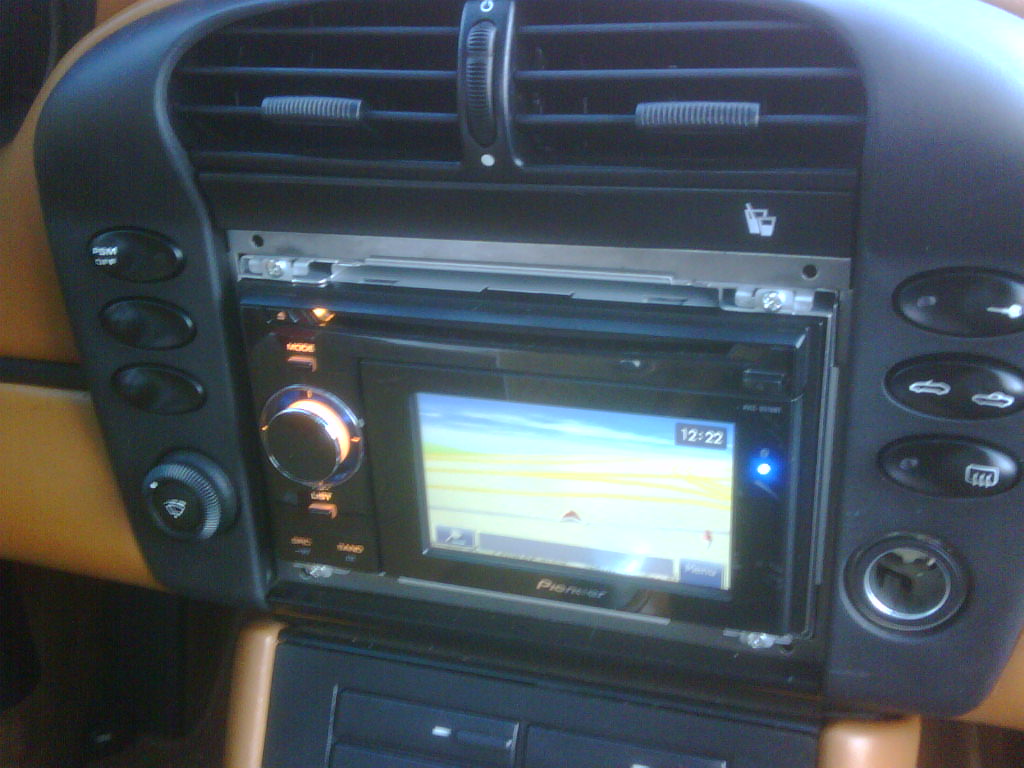

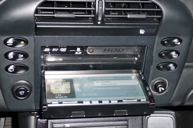

Just installed the Z110BT in my 2002 C4S with Bose. Since this seems to be the reference thread, I'll post comments here instead of on the 996 forum...
dbnichols' and others' observation about there being no good way to securely mount the cage applies to the Euromotorspeed kit as well. There is a plastic ridge on the sides, but none on the top and bottom. After looking around for suitable spacing material, I found that the top and bottom bars of the CCU bezel are the right size and center the cage perfectly. The bars are also the right depth to bend the metal mounting tabs around for a tight and secure fit.
The gaps:
The plastic bars glued in place:
The final fit:
Thanks to dbnichols for the splash screen.

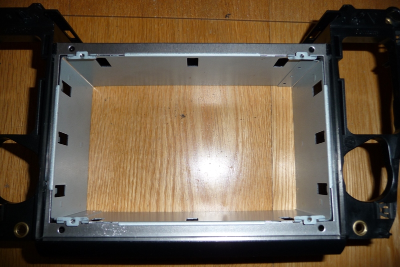

Hi Guys,
A couple things I wanted to clear up and hopefully will make life much easier for folks who install our kits in the future. We've included a cage sleeve for quite a while now with our kits, and it is usually already slid onto the cage for buyers. I guess it would help to understand how it works right...as it is not in our DIY which was based on the very first install we did on my '00 Boxster.
The purpose of the cage sleeve is to create a lip on all sides of the cage (the sides, top and bottom). This lip stops the cage from falling through the factory opening, and sits flush to the factory opening. This effortlessly allows you to set the depth and height of the cage, so that you don't need to do any measuring like in the original DIY.
Anyhow, I have included some photos to show how everything comes together...in pictures of course! Just a little preface, this was my Saturday afternoon project converting the '00 Boxster radio surround area to the 03-04 version with the thin cup holder option. The install is complete and it looks awesome and I love my new cup holder, I just have to clean up my car and I'll have some pictures to show in the weeks to come.

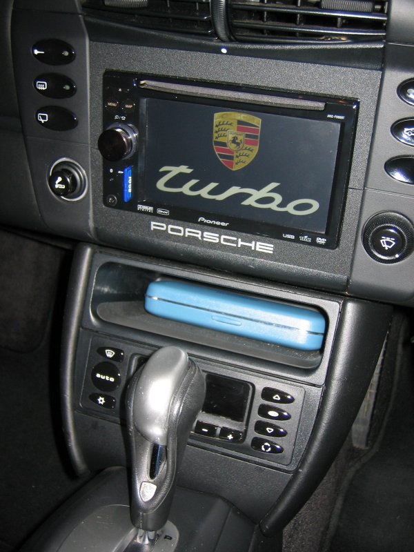

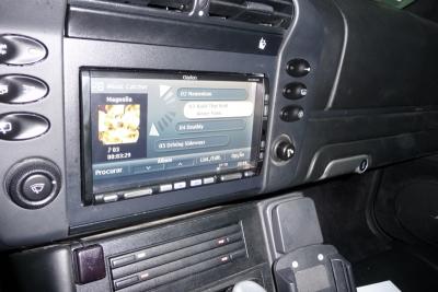

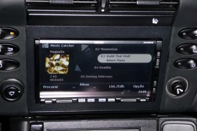

Just completed my refinish of my Clarion MAX983HD install, which I originally did in 2008. When I saw the upgraded 2-DIN kit I decided to modify my install to take the new powder coated bezel.
Since my car was a PCM1 car, the 2-DIN aperture was not centered in the space available and I couldn't use the previous piano black bezel. I used a mix of the Clarion supplied thin bezel and a strip of Trieullionaire's bezel. The result was less than satisfying, so I bought part of the new kit: the bezel and the cage.
The cage itself is a Pioneer product and is the best I've seen, miles ahead of what I had previously (Clarion Universal kit). It fits, slides and looks way, way better.
That said, I had to cut quite a bit of plastic to fit the cage and setter, since the aperture was not centered. The setter was extremely useful in establishing what to cut, thank you! I installed the setter and the cage and reinforced the lower area with Milliput epoxy.
After installation of the assembly, I slid the HU in just beautifully snug. Then I found that the bezel was a bit too snug.... When I opened the motorised front panel, it either spit the bezel out or just couldn't close...
Took the bezel to my Proxxon milling machine and cut 1.5 mm off the lower strip and voila, perfect! I'll post a couple of photos when I shoot them.
Andrew - I bought trieu's piano black trim for my Pioneer. It is very nice in the high-gloss black, but I kept thinking it would look nicer in a satin finish to match the surrounding plastic. I had some vinyl trim tape I bought on eBay for another job, so I took out the bezel, and applied it to the opposite side. The tape wasn't wide enough to do it in one piece, so I did it in two, putting a small gap to match the line in the dash. Trieu had supplied two logo stickers, so I put one on this side too. Now it's reversible if I get fed up!
This is where I got the tape, but I see they now do it in a 6" width: http://cgi.ebay.co.uk/Self-Adhesive-Black-...emZ360214872974
It might be better than you trying to paint yours.
As promised my pics below.
Note the damage to the right edge of the horseshoe :( . A new one is coming from ebay for 50 euro!

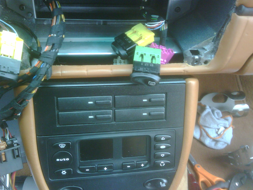

Just completed an install of a Pioneer P3100DVD in my 2002 996C4 Cab. A couple slight differences than installing an AVIC so I thought I would post in case anyone has any questions about installing this particular model using the Euro kit. (thanks trieullionaire!)
This is the only thread I needed to get the HU in, up, and running flawlessly, thanks to everyone who has contributed to the board.
My install was basic, I did not add BT or SAT which are add-ons to this model. I now have full iPod control w/video, DVD video and all the other basics.
The unit itself is a huge upgrade from the Becker. Left everything else stock and it sounds multiple times better. I thought the speakers were weak but not after upgrading the HU!
A couple of differences in the 3100 vs. the AVIC models:
-To bypass you cannot just ground the parking brake wire like other HUs. The two solutions are to install a simple two line switch (run the parking brake wire to it and ground the other one - this is the method I did) Or you can use a 5 prong relay switch (there is a youtube video on how to do this - a little longer to create but no need to flick the switch to start the video!)
-The 3100 doesn't have rca jacks for the speakers, you have to clip off the rca jacks on the euro it and manually connect)
-No need for the heat shield on a 2002 996. The cupholder has a metal base. (saw this on a post here before I installed)
Pretty straightforward install, my only grief was moving the wires for the HVAC down to the lower shelf (not much space in there - but it works and fits great)
