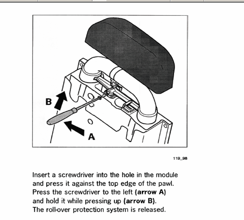

At some tracks (Road Atlanta), they let me run with the popup bars extended. All you got to do is remove the carpet cover behind the rear seates (2 philllips screws), remove the pop-ups covers, then with a small flat screwdriver trigger the lock mechanism. It is a 10 min job, and passes the "broomstick" test.
