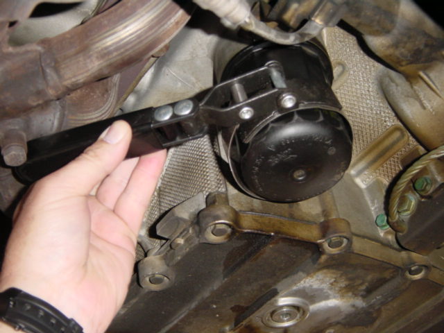

I can't find a wrench that'll work in this city for the life of me.
I did however find an adjustable one, like so:
Will this work? It says it's good for 2 1/4 to 4 1/2. Just worried about it being metal and the cap being graphite...

Kunkstyle, contact your local Mac Tools rep as he has the correct oil filter wrench. I wouldn't use the type in your pic as RFM stated they can cause pressure points and damage the filter housing.
Considering that plastic canister I would not use anything that placed uneven pressure on the diameter such as the ones shown above, especially the strap type. The "B" cap wrench (I forget the brand) is more than adequate and a whole lot cheaper than the Porsche product.
Again considering the plastic canister, you should use a torque wrench. But don't do what I did!!!!!!!! Lying on my back with the long handle torque wrench over my head I failed to feel the wrench "click" at the setting and over-tightened it severely before realizing it. I had to loosen and retighten it, and the plastic can on the aluminum engine binds terribly tight and it takes much more to loosen it. I had to wrap the filter in duct tape to make it fatter so the "b" wrench would not skip/slip, then tap it onto the canister. It's a wonder I didn't ruin something in the process. All worked out in the end, but lessons were learned that I thought I'd share………although ashamed on my error.
