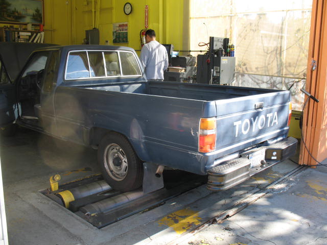

This is the smog **** California. For test #5 my registration notice said I had to go to a test only place. Since my 1997 is so old I can no longer go to a test and repair. My local Porsche dealership was test and repair, and that is who had done most of the prior inspections. I can no longer go to a Porsche dealership for a smog inspection as I had done in the years past. From now on I can only go to a corner test only place, where the inspector does not even know where my engine is.
If I fail at a test only place then I have to go to a test and repair place to have the problem fixed. Then I have to go back to a test only place for a retest. I can't even go to my local dealership for anything. They no longer have a smog machine as the dealership had just been sold, and none of the Porsche mechaincs are smog certified. When my local dealership was recently sold Audi was split off from Porsche, and they are now at separate locations. The smog certified guy was an Audi mechanic, but he was not permitted to work on Porsches.
Fortunately, there is a test only smog place a few miles from my office that I have used in the past. There is also a test and repair place accross the street from my office that I have used in the past but I can no longer go there, as I am now a test only for both vehicles. He now does the smogs on my old truck since it is a test only. After I got the ticket I brought the truck in for an inspection, and told him about the ticket and problems with the Boxster in getting the 5 readiness codes set. He was the one who told me I only needed 3. As I said, at first I did not believe him because the mechanics always told me 5. But when I went on the smogcheck site I was able to confirm the EPA forced California to reduce it to 4 and then to 3.
So I brought him the Boxster. Outside the shop I checked my car with the PST2 and only 4 were set. Then he hooked the Boxster up to his machine and it too said I only had 4 set. This is a picture of his smog machine. So I told him to do the test. I was a little concerned when he asked me to remove the engine lid. When I asked him why, it was because he needed to see the emission sticker. No problem, it is under the rear trunk lid.

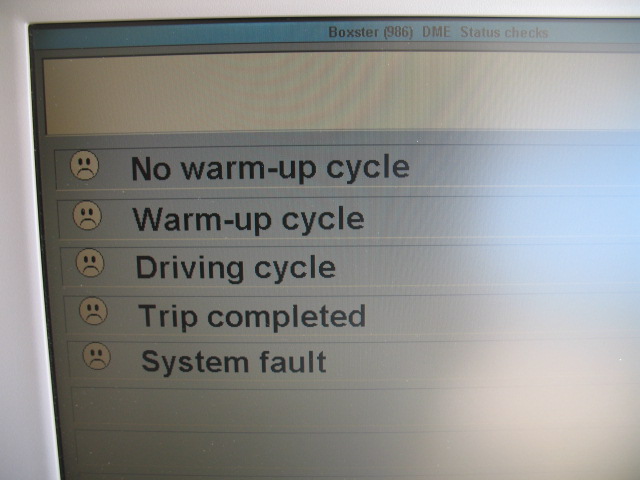

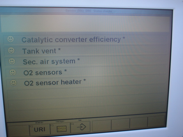

Here are 2 pictures taken on the same day. March 23, 2007. My registration was due March 26th.
First picture all 5 rediness codes are set. Second picture none are set.
Don't remember what I did. Probably disconnected the battery to put it on my workbench for testing and charging, or playing around with the PST2. I know I ended up replacing the battery July 31, 2007.
All I know I was not ready for testing, but I had paid my registration fees on time.
When I finally had the test on December 7, 2007, the measured levels from the sniffer were well below the max, except for HC which was equal to the max.

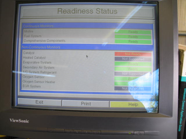

Does anyone know what routine/procedure must run to pass CAT?
The OBD II reader shows all tests have run (Ready) but CAT and it's been over 200 miles since OBD was reset.
According to the OBD spec, the CAT test runs everytime you drive and I wonder why this one is still shown as not ready.
I would really appreciate if someone clearly explains how this test is run.
