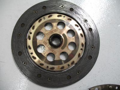

I had clutch chatter when taking off in 1st. 67,000 miles. It was also hard to push down the clutch pedal.
Clutch was replaced yesterday. It was down to the rivets on the pressure plate side, and had started to score the pressure plate. Also typical heat checking on the flywheel.
No more chatter and I can push the pedal down with my thumb. Feels like when I bought it 9 years ago.
