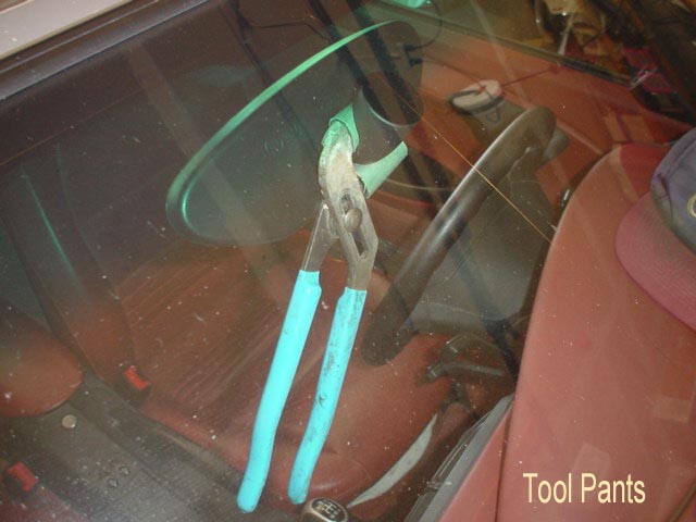

You need this special tool. :rolleyes:
Hmm, It looks like just a pair of lock jaw pliers with rubber attachments on the end. Do you just squeeze and it releases the clips? Or do you have to twist it off? The new mirror comes with that housing, so couldn't I just use a regular pair of lock pliers?
Just channel locks with sections of garden hose so the teeth don't scratch the stem of the mirror. I once did it with channel locks and a piece of card board.
The stem of the mirror has a clip on the end of it that you cannot see. The mount that is glued to the glass has a matching clip that you cannot see. When you rotate the stem of the mirror 90 degrees like Loren's drawing then the clips unlock and the mirror pulls away from the glass.
Loren's diagram shows the special tool which is a modified vice grips that have protective pads where the teeth would normally be.
