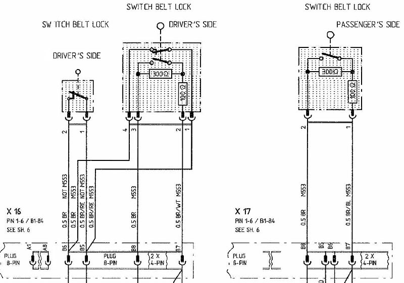

Thanks Loren! That diagram helps a lot, but I'm not sure I feel competent (or lucky) enough to start shorting out jumpers with the ignition on to see if the seatbelt lights go out! :eek: Unless someone has specific info on which switches to wire shut (looks like there are two) or whether something more than simply running a jumper between the two wires is required, I'll probably give up on this project. I don't want to be the guinea pig on this one!

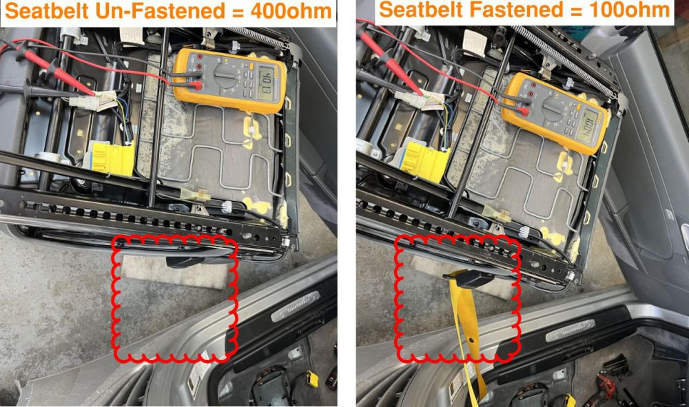

I was only able to speak to Peter for a few seconds. You jump two of the wires with a resistor. The resistor can be 100 or 400 ohms. If your air bag goes off then they can tell from the control unit if the belt was 'buckled.' If you use a 100 ohm resistor the control unit will think it was buckled, and with a 400 ohm resistor it will show unbuckled. Jeff

I think the circuits with the resistors are shown with the 300 ohm resisitor to be shorted when the belt is in. The switch shown with the short bar connected to the diagonal line is shown "normally closed", meaning it opens with the belt buckled. If I'm right, that would mean opening 1 to 4 on the M553 driver's side would keep the light on the dash out.
Patrick is in charge of the electrical stuff from now on, ok Loren, he got it right.
Peter said to run the resistor from pin 1 to pin 4 wire so the light will not go on.

I spoke to Peter today and I misunderstood what he said to do. You hook up a 100 ohm resistor to bridge pins 7 and 8. On Loren's diagram for the passenger side follow wires 1 and 2 down to pins 7 and 8. On the drivers side follow wires 2 and 3 down to pins 7 and 8. Jeff
Jeff,
The 100ohm resistor will prevent the air bag light from coming on. The seat belt warning is the other contact on the switch, 1 to 4 on the plug under the seat. (5 & 6 on the other conector). Opening that circuit (or not having the receiver installed) should prevent the light.

Just did my seat belt harness mod, and wanted to confirm for others out there that Patrick's statement about leaving the circuit open for pin 1 and 4 will remove the seatbelt warning light.  Another way of looking at this would be to use the passenger seatbelt buckle for the driver side which would yield the same result.  I originally had jumped 1 and 4 which kept the light on, removing the jumper disabled the light.
