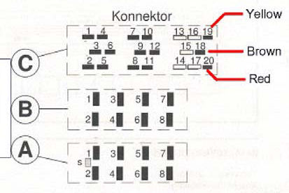

You can do it for $2. Buy an cable that has the headset jack on one end and the RCA ends on the other.
Cut the RCA ends off and put some small electrical connectors on them.
Put the two grounds together and you will be left with 3 ends.
Attached is the back of your deck. Attach the 3 wires on the back there.
Turn on you AUX setting and away you go.
Can be done for free if you already have the cable.
Phone__or_Aux_1_audio_input_directions.pdf
This is not a hard DIY. It took me less than an hour once I had all the parts, and it was my first time taking the center console apart. Once you get the Becker AUX cable, you needs a PIE-RCA cable. Wire the power and ground to the telephone connector, and hook up the RCA cables. You will probably also need a ground loop isolation.
