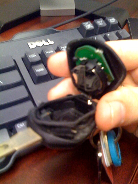

It's a one-button key for a 1999 996. I just stuck my thumbnail in the crack and gently pried it open. The board is just held in with two clips.
Just be careful not to lose the rubber ring.
Sorry for the blurry picture. The camera on the iPhone is about the most worthless thing ever, and my real cameras are in the car.
For the key in the picture it isn't getting the key apart it is getting it back together. I read somewhere you have to put the remote in the top half of the fob (the part that has the buttons) and then put the two halfs back together. You would think you just put it in the bottom half, I tried that and the key didn't seal.
