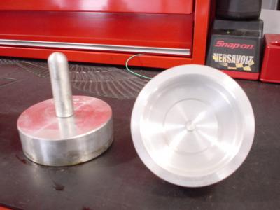

This is the measuring tool they used. It didn't just slip right in--he had to move it around a bit--is that normal?

The TSB for the measuring mandrel is on the board. It was issued on March 3, 2003. The mandrel is supposed to slide in the seal bore with slight resistence. If it does then you get another seal.
