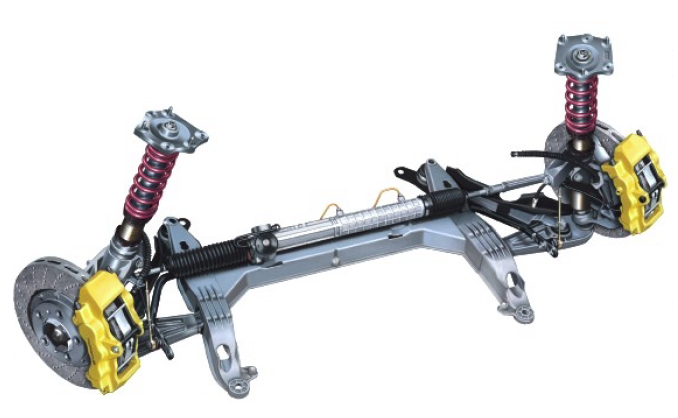

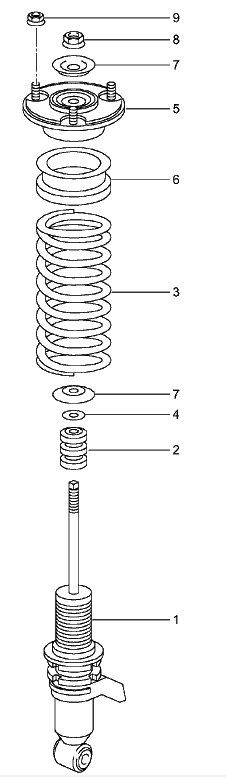

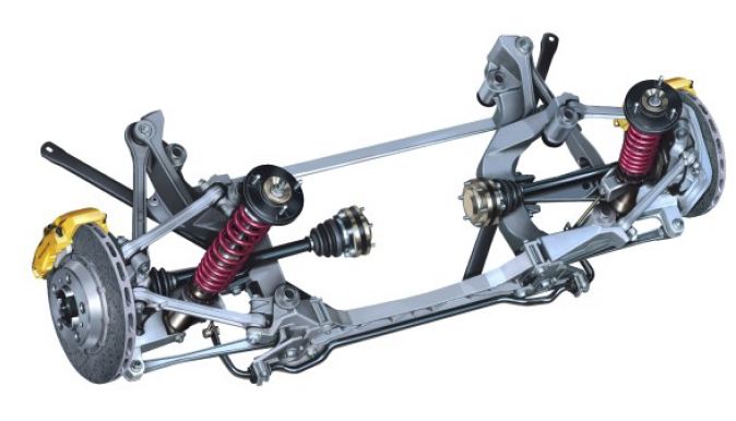

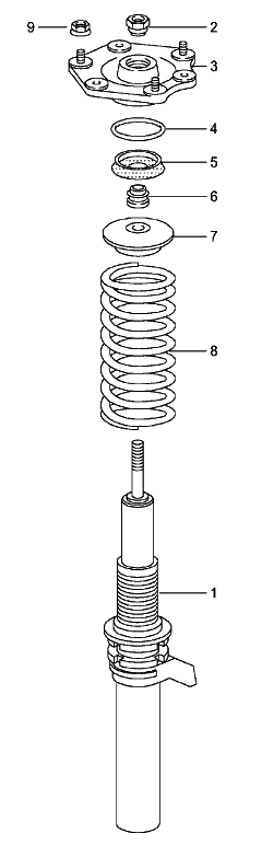

Please post photographs or a pictogram of the stock GT2 and 996 Turbo suspension. I am hoping to find the differences in how the two mount to there respective uprights.
The purpose is to show me the hardware neccesary to have a set of OEM GT2 coil-overs fit onto my 996Turbo. I've been in touch with Moton, who makes a sleeve for the front upright, but don't have a way of finding out what else is needed.

You will need special drop links if you are using GT2/GT3 swaybars.
You can get them from Carnewal.com
For the time being I'll be using the stock 996TT swaybar and drop links. I'm just hoping to utilize this set of GT2 C/O's on my Turbo. Thanks for the quick reply Loren. Your expertise is appreciated!!
I am confused as to what you are asking. The GT2 uses coil overs so they should have all the hardware you need.
i need spring perches and locking rings from the stock GT2 suspension, because the PO of my C/O's used them with his zmoton replacement.
Also, actual pictures of the GT2 suspension would be extremely helpful

Can anyone tell me how much or where to buy the front spring caps? I'm attempting my GT2 to 996tt swap soon and think I'm missing those off of the GT2 on the front. All I have on the front is the shock, springs, and collars on the bottom. I know I can swap some pieces over from the 996tt strut tops to the GT2 tops but I think I'm missing some special GT2 pieces like number 4-5-6-7 in the diagram above. Any help would be great.

NOTE: The top mounts from the 996TT work, but I have to be honest, the fronts make me a little nervous. The nut that secures the strut bolt thru the top mount assembly(look at Loren's post #7, the GT2 front pictograph, piece #2) only has one thread showing above the nut. It is secure, but one would be much better off purchasing some Mode pillow mounts or whatever they are called, for the fronts. The rears ride up in the stock top mounts just fine. The rear stock pieces were reused, but some of the rubber was removed and the springs hats are metal to metal(except maybe a thin rubber lining covering part of the area needed).
