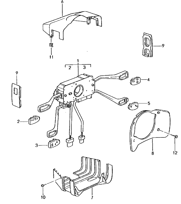

The other day I was making a left turn and my signal was on and as I did the turn I heard a plastic snap sound come from behind my steering wheel. Since then my signals work but the steering wheel does NOT shut off the signal after the turn. Loren, I was wonding if you could give me a column exploded view from Porsche? I don't think it is my cable reel for the ABS, most probably my combo switch, but I am curious, if I need to replace the whole switch or if it is a ring I broke or something
Thanks
Sorry, Porsche does not sell just the stalk parts only the whole assembly.
If you want just the turn signal part you might try a salvage yard. It is a little more work but a few folks have changed out just the turn signal switch.
Item 1 - 996.613.219.10.EWC is the whole assembly -- US MSRP $248.18. Sunset Imports (Porsche parts at Dealer Cost) can likely do better than that.
Thanks for the Pic Loren, I took it apart actually and what I broke is the return plastic on the clock spring unit. The part that returns the signal back to go. Do any of you know how to take off the upper clip (grey) on the clock spring? I think I will need to replace it. And I already shop and the plugged porsche dealership :)
